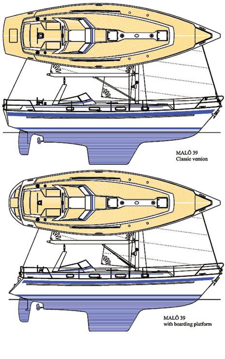

#14 ·
Fast.
This is the underwater profile of the M39. I find that she backs up pretty well providing you have the cojones to give her a bit of throttle. It can be a tadge alarming in close quarters but she is quite controllable. Mind you having a bow thruster as backup has made me less of a wee timorous beastie than I might otherwise be. :)
Not, I must add as controllable as the fin and spade of Raven. She backed up like a car. Fast or slow, no worries.
Boat I had before Raven was full keel cutaway forefoot. Reverse ? Don't be silly.
#17 ·
Fast.
Kukka has a relatively narrow chord keel, and the rudder is more spade than skeg, esp with the proximity to the prop skeg section, I'm not surprised she backs up alright.. Nice compromise.
Of course you're planning to sell that bow thruster (spelled C-H-E-A-T-E-R) to some truly needy W32 owner, right?:p:)

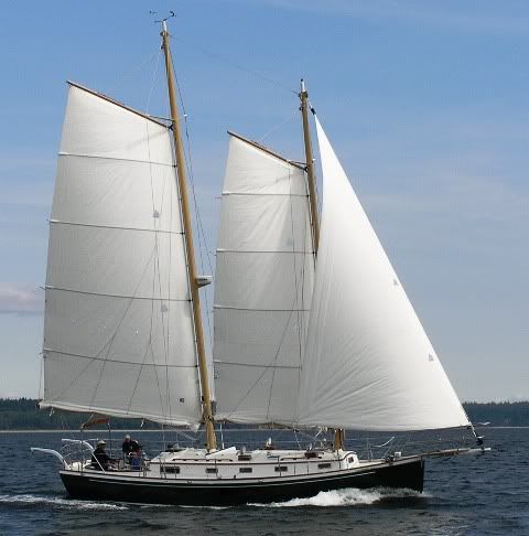

#15 ·
btw ... in case anyone is thinking I was having a go at gaff rigged schooners, think again.
I seriously doubt we would go past this beauty ....
Bob Perry's Jakartan.
I would.
Reactions: elspru
