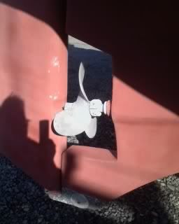

Here's a photo of a friend's 32.5 Morgan which clearly shows it would be difficult to take out the rudder or prop even when hard aground.
