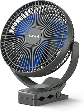

I have a couple Caframo fans, but I still find them a bit loud. Lately I like portable fans as @bristol299bob said, but I like this one. It is dead quiet, runs for a couple days on low, stands, hangs, or mounts on a screw. I sometimes hang it in the hatch to blow down, mount it on a screw in the companionway to blow out (or in), hang from a hook like a ceiling fan, put it on the sole for an upfan that helps when I'm using a heater, just stand it somewhere, or it fits nicely in one of my protected portlights when it is raining.
