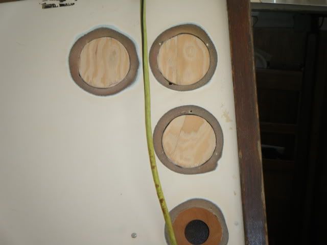

I see that you removed old guages from the bulkhead next to the campanionway. I have to do that. I'm going to look at your blog now, but It appears that you cut some marine ply and fitted them in the holes. Can you tell me how you backed those, then did you just epoxy them in then fair?

Or are you filling in large holes like the removed instruments, where plugs have had to be fit? If you have fitted something like wood plugs, they should be sealed, preferably with a penetrating sealer, and faired over. Otherwise they would absorb the "paint" products differently and telegraph through--unless your coating says that's not necessary. Products differ, and whatever the instructions for the product you've chosen say, is the best advice on how to use them.

The plugs were cut to match the original core and epoxied in the glass was beveled out to a reasonable distance and then a layup was done to the original thickness finished with some fairing compound
