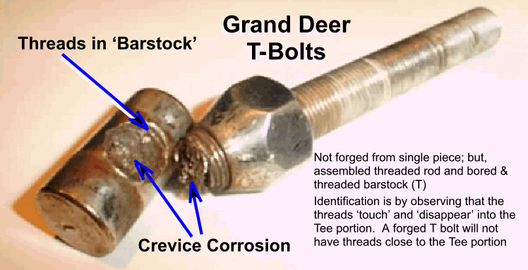

Im Ty37 #423 and I back-calculate a SF of 4! for the Ty37 rig ... BUT about 0.2 SF for the OEM Grand Deer toggles, etc. & have had 'surprise' failure w/ the toggle bolts when I first got this boat; and, about SF=2 if the chainplates arent routinely torqued. :-(
