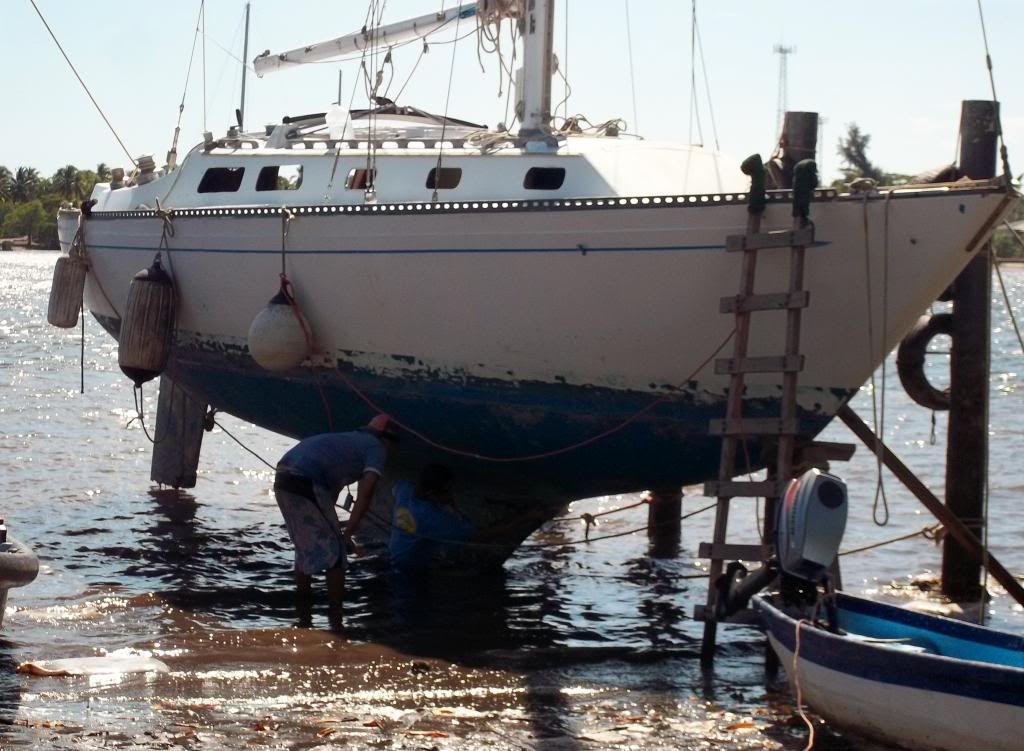

careening el salvador style!
See less See more
Reactions: 1

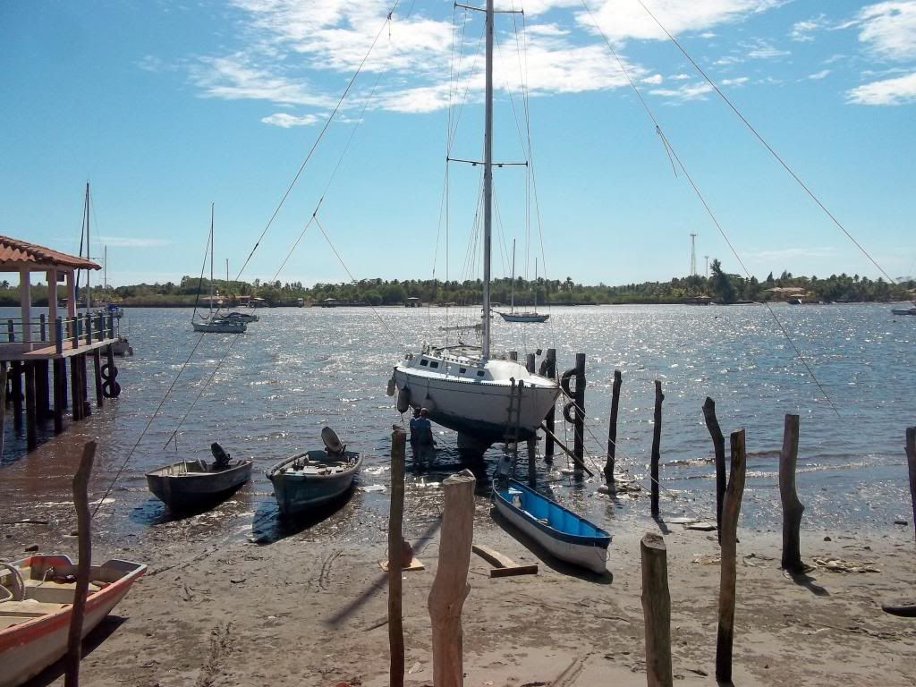

a general view!
you can see the 4 lines from mast to 4 anchors in mud with chains...pilings are galvanized and all you have to do is get the correct 2-3 degree tilt and winch the boat fast to the pilings
tomorrow bottom paint...today was grinding the hull keel joint, 5200 fast cyre in places and some glass patchwork in some areas...to help
simple but you need to work fast cause of the tides...well see what happens tomorrow!
peace
Im spent!
gravy baby
See less See more
Reactions: 3

Wow! I am amazed that the hull can handle the load in that direction.
youd be surprised what these and many boats can handle must get the angles right and not move the boat after its still
funliily enough I was on another thread where there was a boat left in a similar situation but it was a pure fin keel and small...and it was at an angle stuck in mud and not made fast to anything like when careening...that would be bad for a prolonged period for sure
btw the keel is on sand bags,,,which is much softer and kind of wraps around the keel base

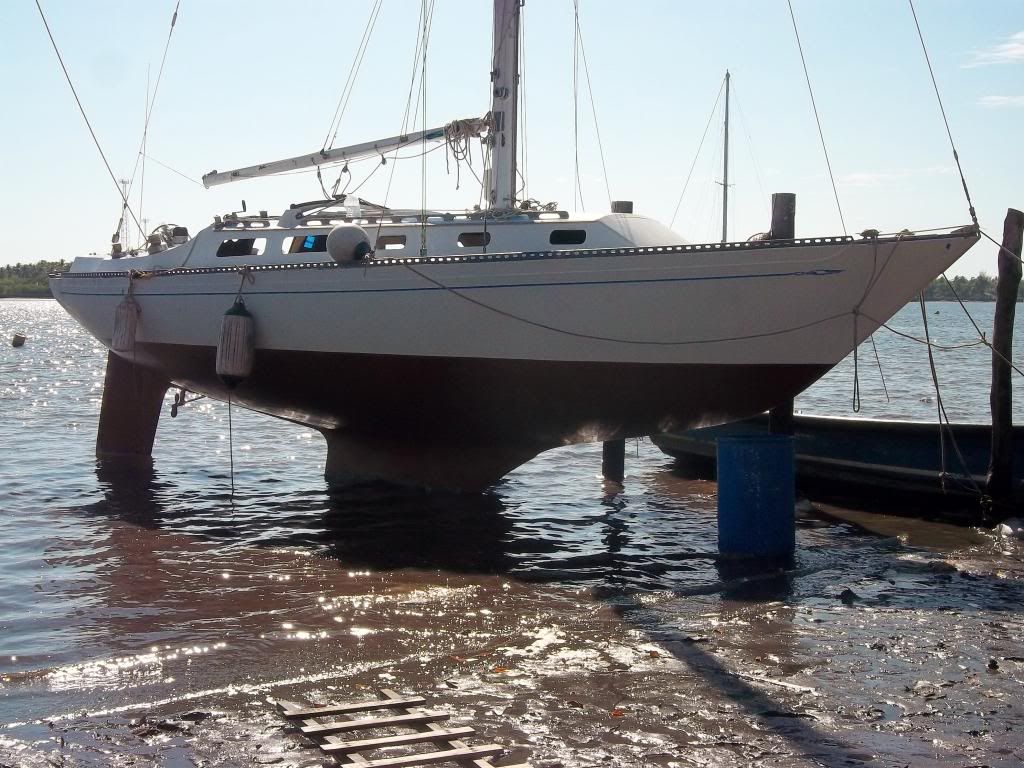

paint and patchwork done
tonight at 9pm she is back on the mooring!
yay
little paint, glass work at the keel and a nice wet sand of the topsides and she looks a bit better huh
mand did I get sunburnt with the glare! ajajaja
See less See more
Reactions: 2

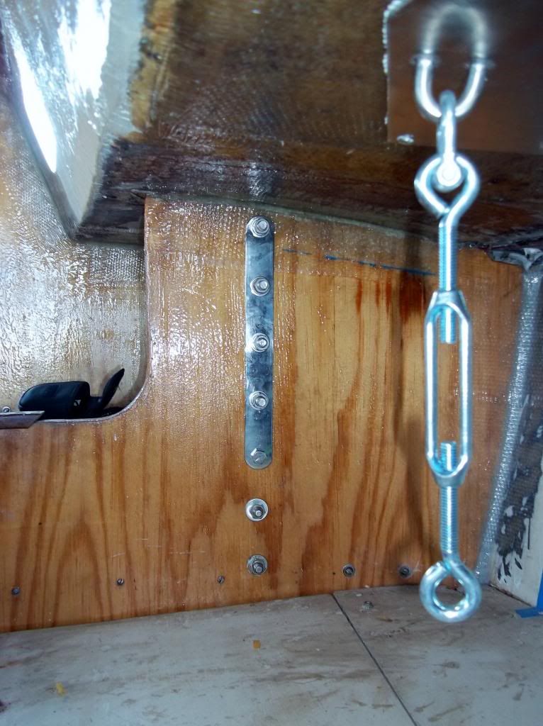

here is my main stb bulkhead with backing plate and extra bolts added...notice little jumper strut attachment for the aft lower
See less See more

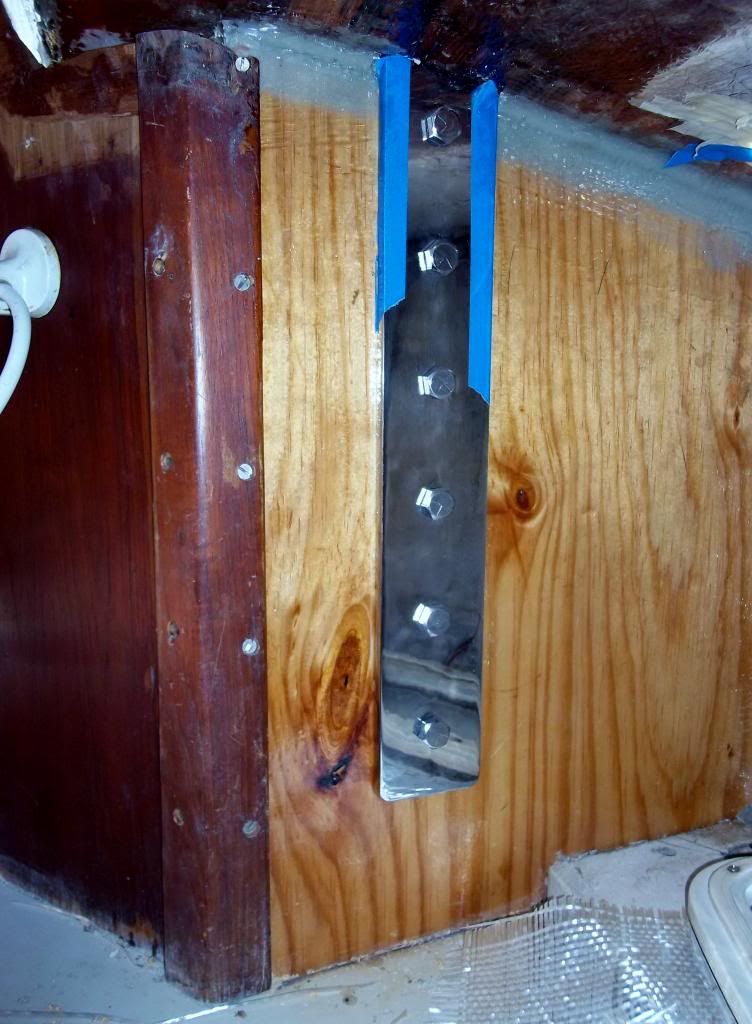

port plate installed...
next is to paint the glass work and trim
See less See more
