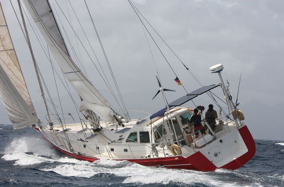

One of my bigger boats MARLIN having some powerful fun on the coean with the big pilot house door wide open.

The black boat is the 70' LOA 24,000 lb., MERIDIAN, a very fast and docile cruising boat that lives in Seattle. I designed this boat about 25 years ago. Tis photo was taken right after it was fitted witth the Leisure Furl system on the mainsail.
