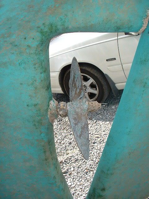

Aperture:
photo taken from here
Hopefully your prop looks better than this one. :eek: Plus, he should have left more room for his cutless bearing to self lubricate. :eek:
See less See more
Great. Now he will need to google "cutlass" too...:)
