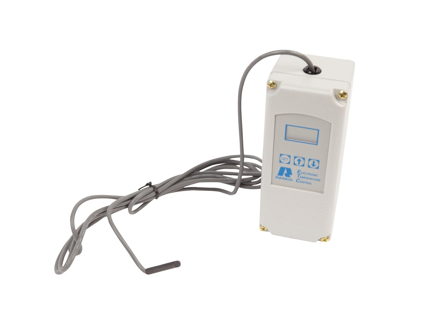

Truth about 120 and 240 volt refrigeration is they don't always use a T-stat. The temp is controlled by a low pressure controller usually nounted on the low side (suction line) of the condensing unit.
Amazon.com: RANCO ETC-111000-000 Electric Temperature Control: Home [email protected]@[email protected]@http://ecx.images-amazon.com/images/I/[email protected]@[email protected]@318H2XYlATL
