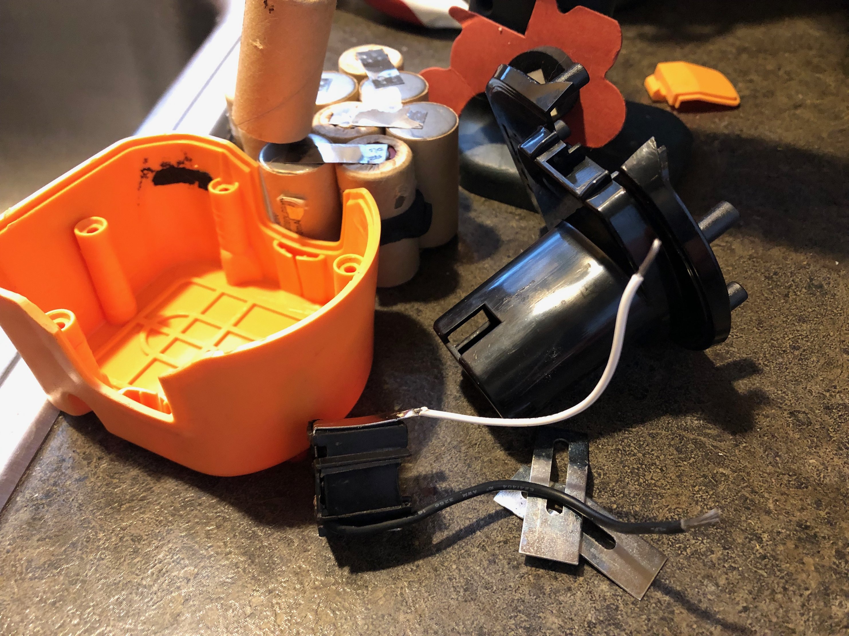

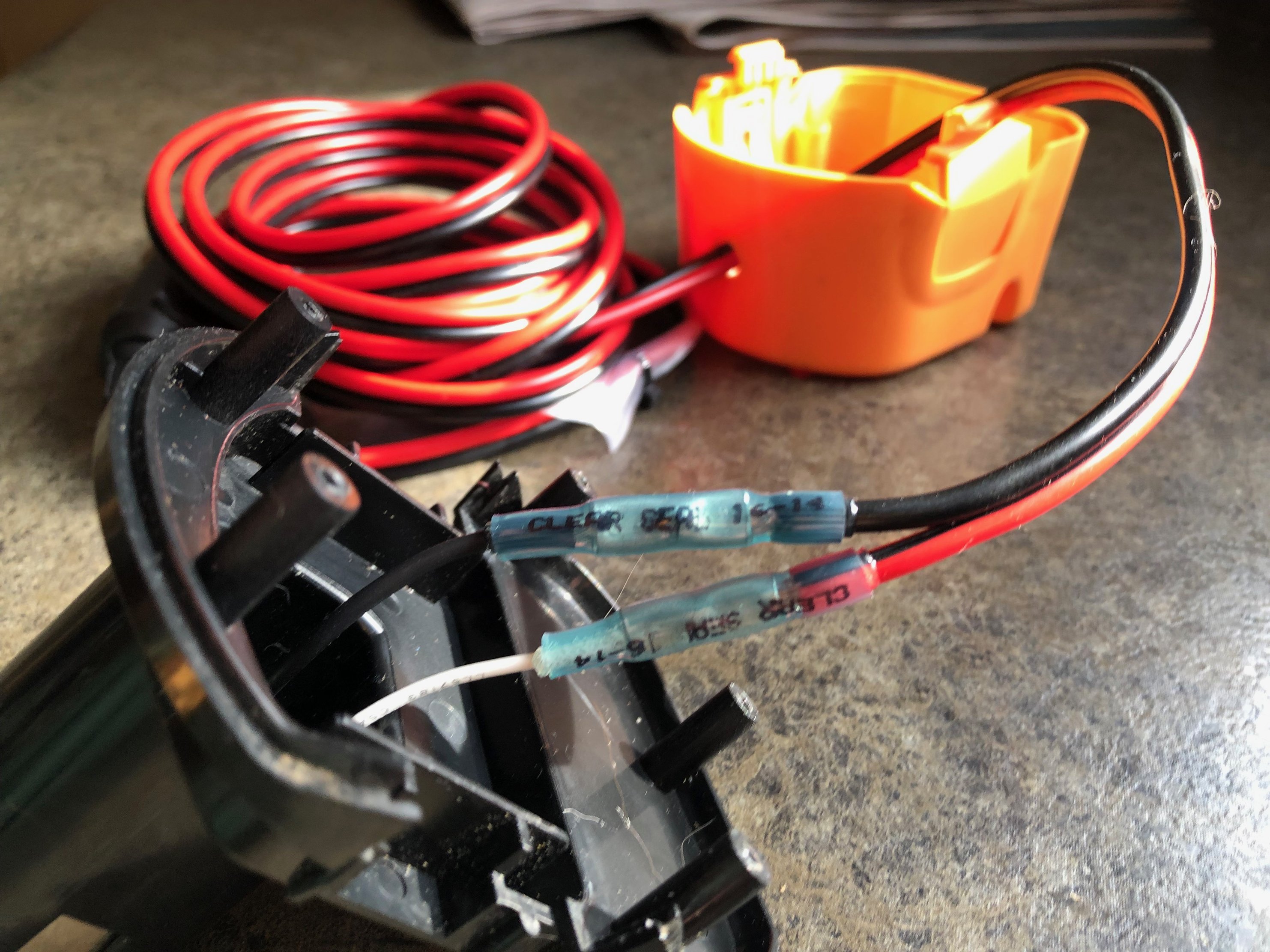

Corded 12-volt drill
I don’t have an inverter on my little boat, so I’m limited to the charge on my cordless drill. Also the drill is usually at home when I want it on the boat.
I have this 20+ year old Ryobi 12-volt cordless drill whose charger finally died. Instead of tossing it in with the electronics recycling, I re-purposed it to be a dedicated boat drill.
I took apart the battery pack, removed the batteries, drilled a hole in the back, and crimped on 16 AWG cigarette lighter adapter and cord.
Viola, now I have a drill just for my boat! And no need to worry about recharging anything. Total cost $10 for the cigarette adapter and cord.
136 Posts
thank you!
I need a boat drill for all the obvious reasons, and I have a few old 12v drills that I was going to toss.
Thanks for posting this before I actually tossed them in a dumpster.
