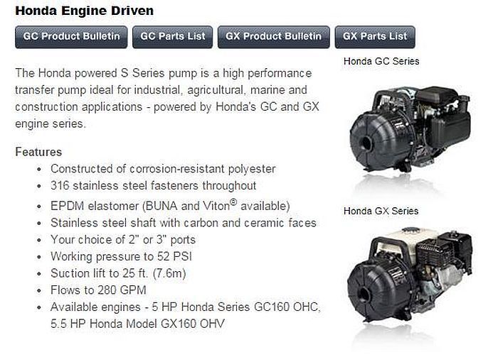

Probably a Pacer pump either on a pto or gas powered for large capacity water removal. Problem of the pto is that if the engine dies you're sunk. Gas powered can be placed on deck well above water level.
Honda powered 15,800 gallons/hour about $800
Briggs & Stratton powered with same output under $500
