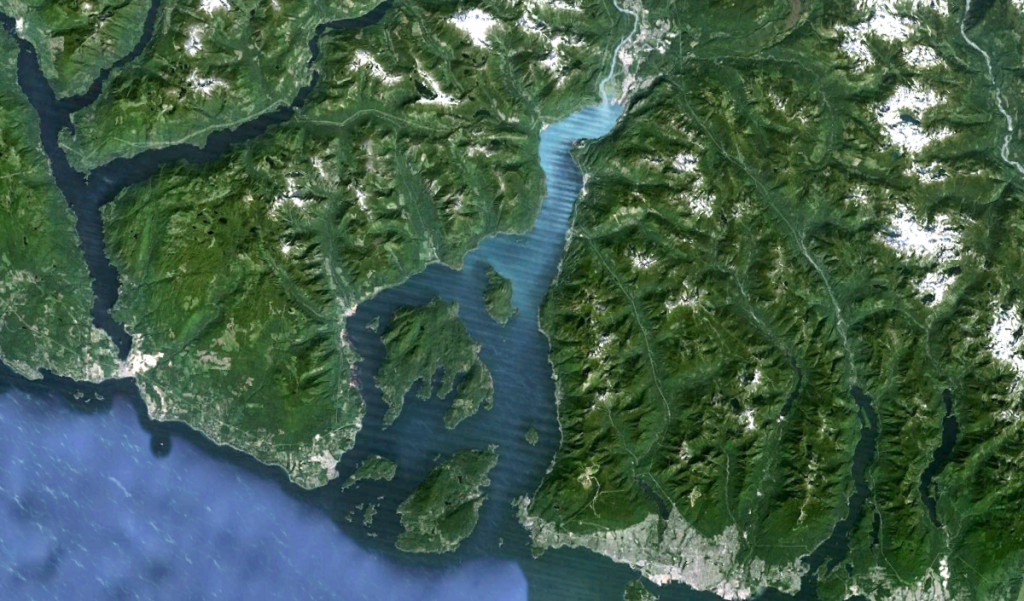

We sailed for over 20 years in an inlet fed by a sizable glacier field.. in spring the surface would be 'glacier green', but any larger vessel would 'stir up' salt water from below the fresh layer and leave a 'blue' wake.. our depth sounders would often read the interface at anywhere between 6-10 feet, esp where it was deep enough that a true bottom return was unlikely.
With daily twenty knot winds typical, I can assure you that surface waves were always present.. pushing hull speed they became significant, and I can't say we noticed much in the way of inexplicable losses in speed.
Of course, we wouldn't see the sublayer waves and they may well have been there, but I never saw a lack of surface wash if the boat was moving at any decent speed.
Perhaps the depth of the layer is important? or the relative depth of the hull? or?....
This satellite shot shows the fresh water extent quite well...
