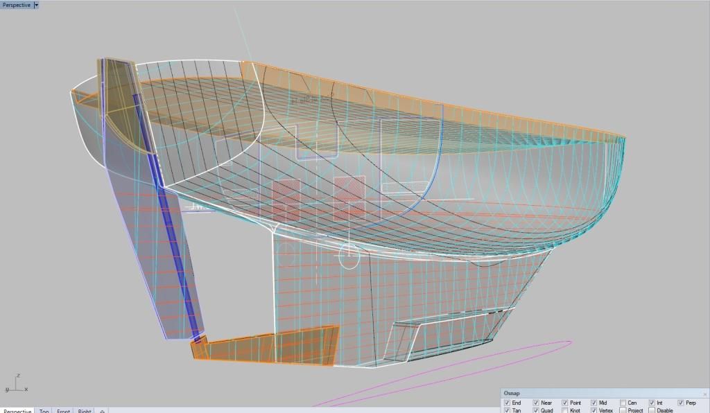

Dion't know that there is a specific name for that kind of rudder attachment but I'll call it Albert.
It's been done before but not exactly like the way I have it.

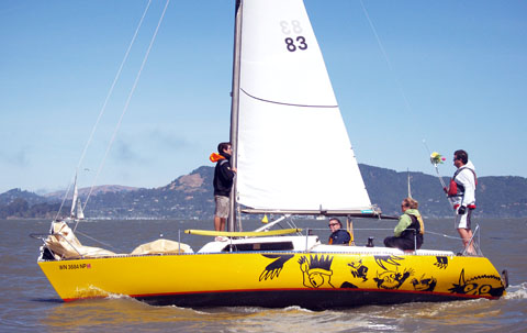

This is my design ICON, all carbon hull and an all carbon deck, built 15 years ago and still going very strong.

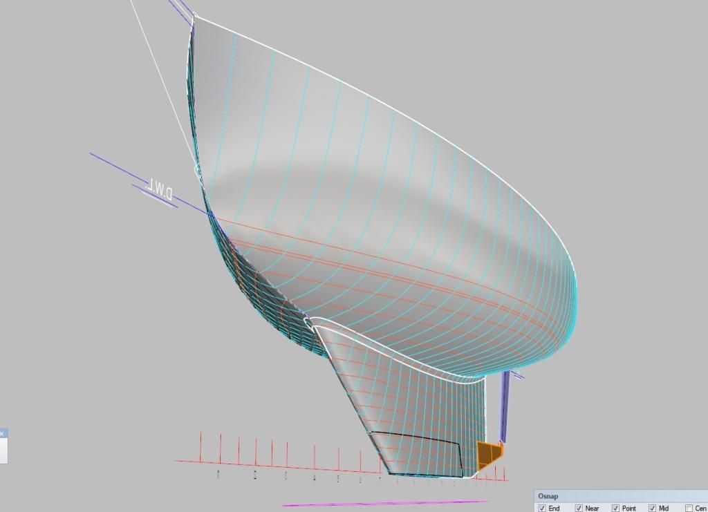

Cutter rig cleans things up and makes life easier for me. Interior is custom so you can have any detail you like that fits. Keel will be the same as CATARI. Yes, it will be built at PSC in Washington NC, one of my very favorite places. Let the wild rumpus begin!
