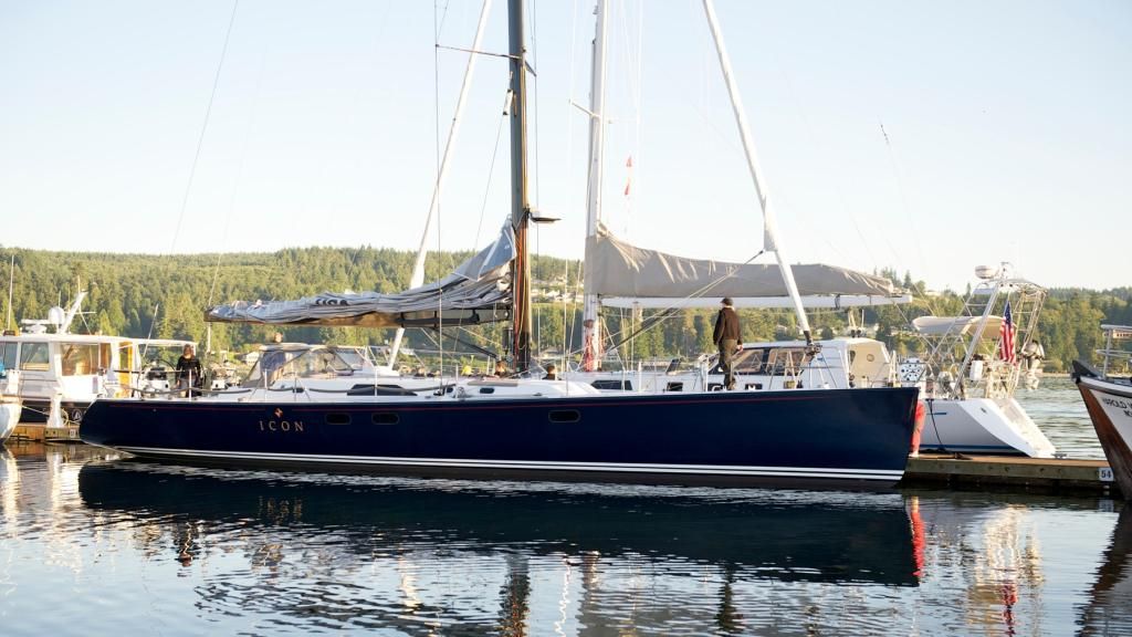

This is my design ICON, all carbon hull and an all carbon deck, built 15 years ago and still going very strong.
See less See more
Reactions: 5
Freakin' cool.
