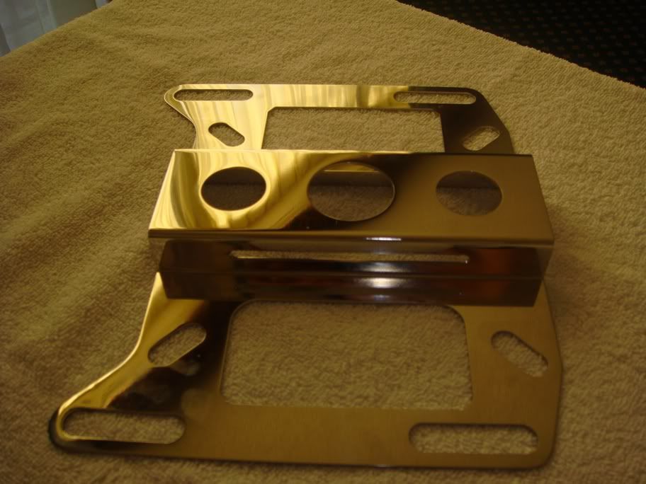

Next we have the Radar basket, as they call it..here I had a bit of bad luck..I bought the Carbon fiber one, but unfortunately, a problem with the CF manufacturer/vendor caused the basket production to have a small hick-up..Seaview immediately contacted me, and proposed that a SS one be made, and it would be only 2lbs heavier than the CF one, and once the CF ones are back in production, Seaview will send it to me.
Now..this is high quality finish!!
The basket is composed of 2 elements, the structure
and the base plate
The base level of finish is incredible, from the quality in the bends on the tubes to the welding, to the machining of the head piece
The head is so shiny that in the photo it was reflecting the ceiling of my room, and the hole is tapered and has a key slot, all extremely well achieved.
On the bolt side, there is a whole so that the locking nut is flussh inside the head!! This is the level of detail that matters to me.
They even made a special name plate with Seaview cut in the metal, by CNC machines.
The base had holes done to reduce weight and I can shave my self on it!!
It has a slot, that allows the radar to be adjusted in the 3 axis!!
Check the finish on this, this is high quality Stainless..all was done to reduce weight..incredible

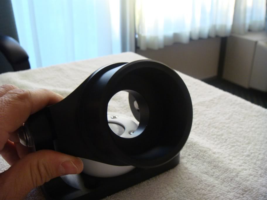

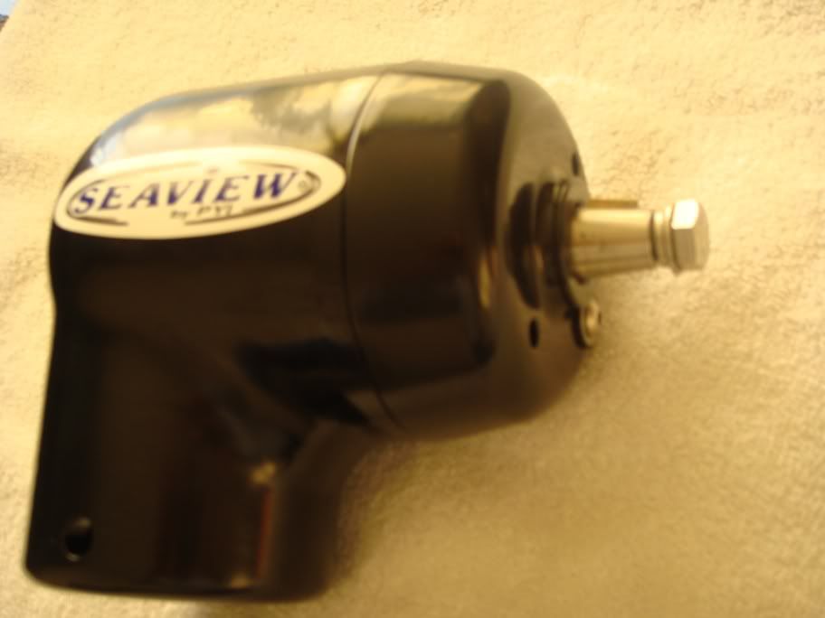

The gimbal is a hydraulic damper, that comes filled with oil, ready to use.
It's a no maintenance unit, that will not require an oil change often.
That part was custom for this unit, and specially painted too, it is a bit heavy, BUT, the quality and the damping action is extraordinaire, and will for sure keep my radar horizontal at all times. I save the weight in the rest and get the best damper.
the damper has a keyed conical shaft, with a large bolt and locking nut on the end.
there is an oil filling hole.
and as you can see, the gimbal enter the tube on the outside.
This is a general view of the unit, sorry I can't get it to sit upright..but once installed, it will be nice..
