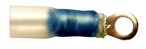

Get a pair of these;
Cut the push pin connector off.
Strip the end of the wire, and put one of these on each of the ends of the wires;
Use a crimping tool to crimp the connector to the wire;
Use heat to shrink the jacket around the wire.
Replace the push pin connector with one of these;
