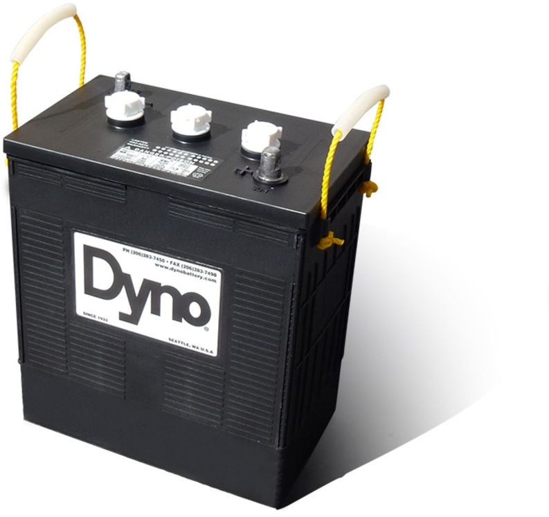

I second the 6volt series setup if you have the room I'm trying to find the height for this battery Dyno Battery - Premium Quality Battery Manufacturing - Made in the USA and at 315 ah with a 180 min reserve at 75 amp draw but would take a heck of a solar charging setup to recharge waiting on he company to tell me how big a loan I will need for a total of 4
7,866 Posts
693
Looks to be almost midway between a T-105 (220 AH) and an L-16 (370 AH)
I've never understood the theory that it will take longer to recharge really. As long as your daily use is the same the recharge time will be similar. The advantage of a larger bank is you will be using a smaller percentage of it and therefore will experience a much greater number of cycles before battery replacement. You will gain economically as the gain in cycles will more than offset the additional cost.
Due to this one of the best things you can do to a battery bank is increase its size.
islander bahama 24
1,842 Posts
419
It is the 4h I was trying to find the 5h like the dead ones I was given as salvage same footprint but almost twice as tall looks like the fisheries l16 unit is the 5h unit I want but personally I would rather go factory direct they are made a few miles away from my marina

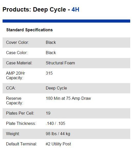

It was the 4H I was referring to. Cannot find a 5H on the Dyno site, but can find the D350, basically an L-16 size battery @ 350 AH.
Is this for your boat or your father's Spencer 42?
Here are the specs on the 4H
