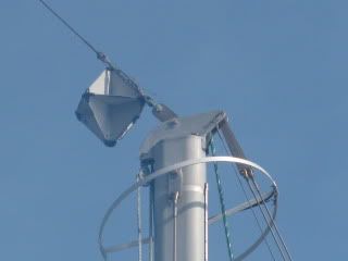

I have 2, 3-point bridles for each reflector. the bridles attach to the top and bottom of the reflector and ensure that the reflector remains in the proper orientation (so called "catch water" orientation). the 3 points of the bridle are joined to a swivel so the whole mess can rotate about the axis.

Hmm.. can someone attach a picture of this bridle arrangement. My brain is not powerful enough to comprehend.
