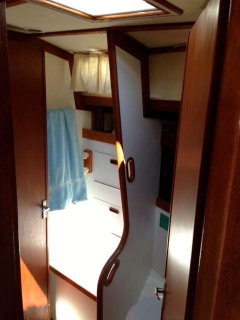

im doing a full refit on my irwin 28 a leaking hull deck join(common)/ missing joint screw's caused leaks into the cabin rotting all the teak bulkheads. i yanked one side out and am replacing it with cored fiberglass panels and am going to edge everything with mahogany. i used a 1/4" chisel like said above to remove the plugs. its was the best thing i have seen other ways but your never going to reuse them gain so just chisle them out and taper plugs are the best for fit i think
Where did you get the cored fiberglass? G10?
And how are you going to fix the hull deck joint leak?
Made it 3/4'' rigid foam from the hardware store with 2layers of 12oz biaxial and one layer of 6oz Plain weave s-glass on both sides then tape the edge with 2layers. I also vacuum the panels when I lay it up for best resin to glass ratio. Never have to worry about rot again and it's harder than wood
Hull deck joint I'm striping the gel coat 6'' each way they going to router the edge round smooth with epoxy/milled fiber mix to keep the shape then lay 3 layers of tape 2'' plain weave 4'' biaxial tape 6'' pain wave and peel ply it to the hull to dry then sand fair and paint. The whole boat is getting repainted inside and out
