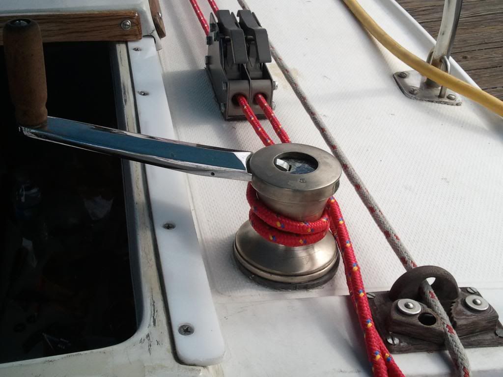

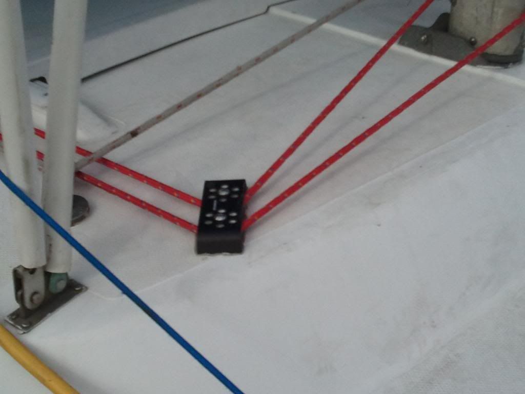

I am going to do the same on my Coronado 25 BUT I am going with 3/8 as its easier on the hands AND I have the lines ready to come back to the cockpit, cabin top winch and rope clutches. I do have to change the sheaves cause I don't want my lines ruined by the grooves, I am also going internal and coming out the bottom of the mast. The red line in the pics is a fake just to line things up.
