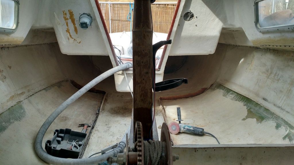

A very unseasonably warm couple days gave me a chance to start playing with power tools, here's a recap:

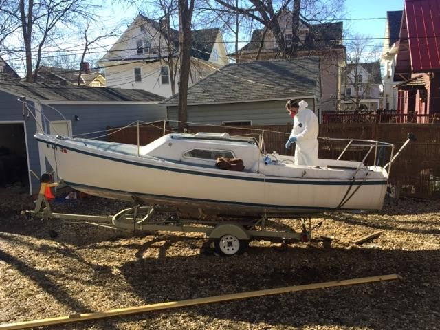

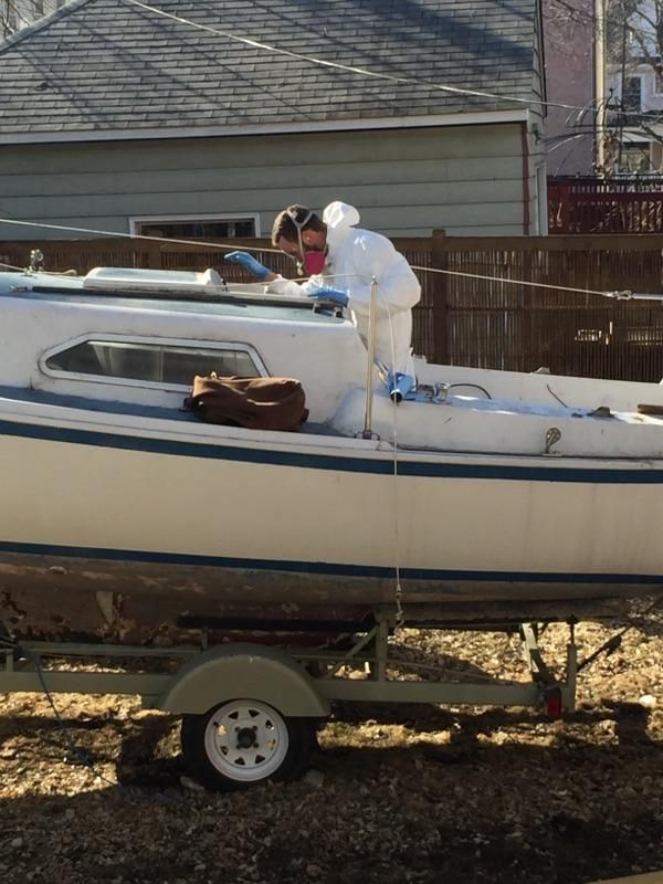

Brought a couple Tyvek suits, respirators, and face shields home from work. Fiberglass is no joke. 1st pic shows the mast sans standing and running rigging. I can do the running myself, still working on a plan for the standing. Been quoted ~$700 by one place locally but that seems a bit steep for 6 wires.

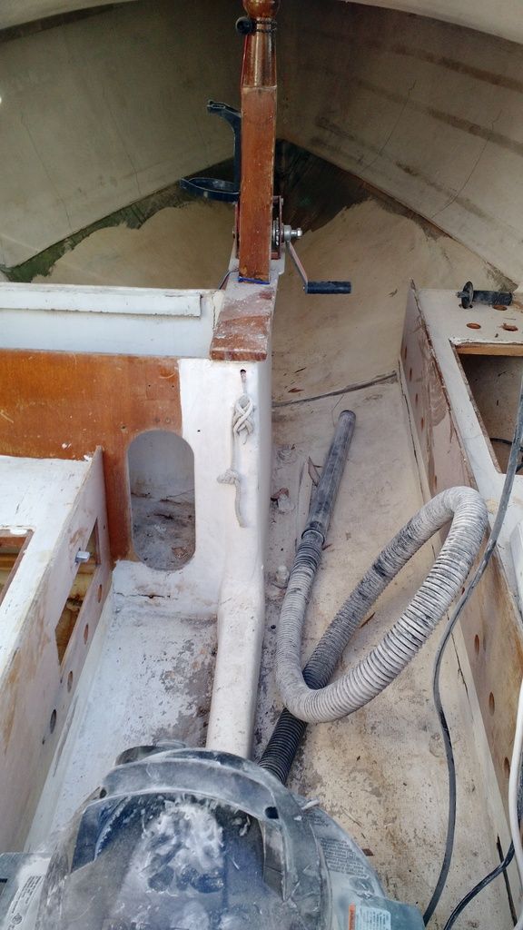

15 minutes of grinding, and there's already fiberglass dust everywhere. Oh well, that's what PPE and shop vacs are for.

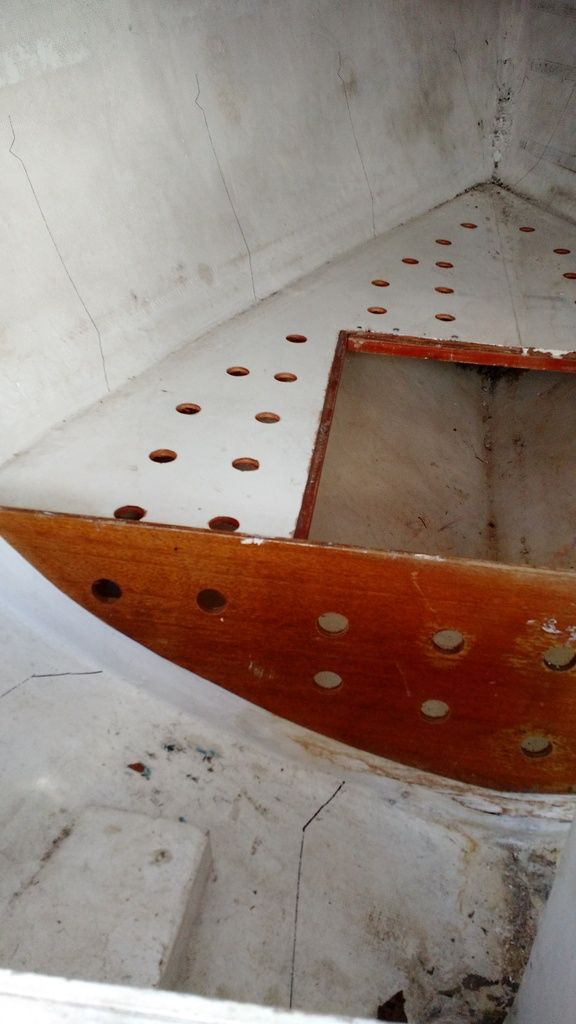

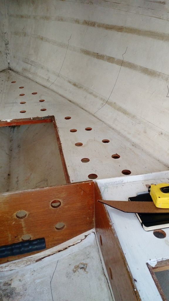

V berth out, apparently somebody at Schock was lazy with the paint. There doesn't appear to be a layer of gelcoat on the inside of the hull?

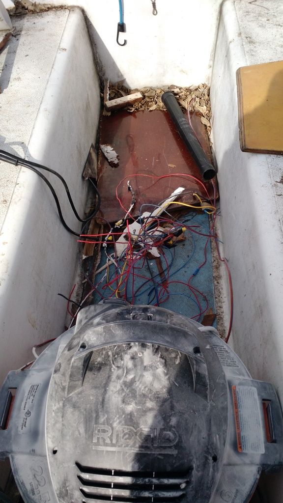

Rat's nest of 50 year old wiring. To the trash with theee!
Starboard berth out.

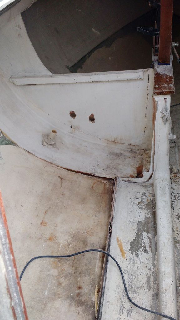

Port berth out. Instead of a berth we're putting in two jump seats with a table, we're not going to be doing much sleeping aboard. Planning on removing the through-hull for the sink and glassing over the hole to clean things up and free up some space. Going to put two 12V 100Ah Grp 27 AGM batteries under the seat against the bulkhead/ keel cutout for house and trolling motor juice needs.

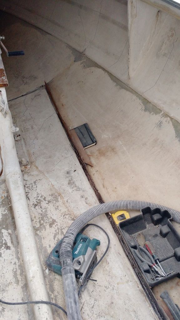

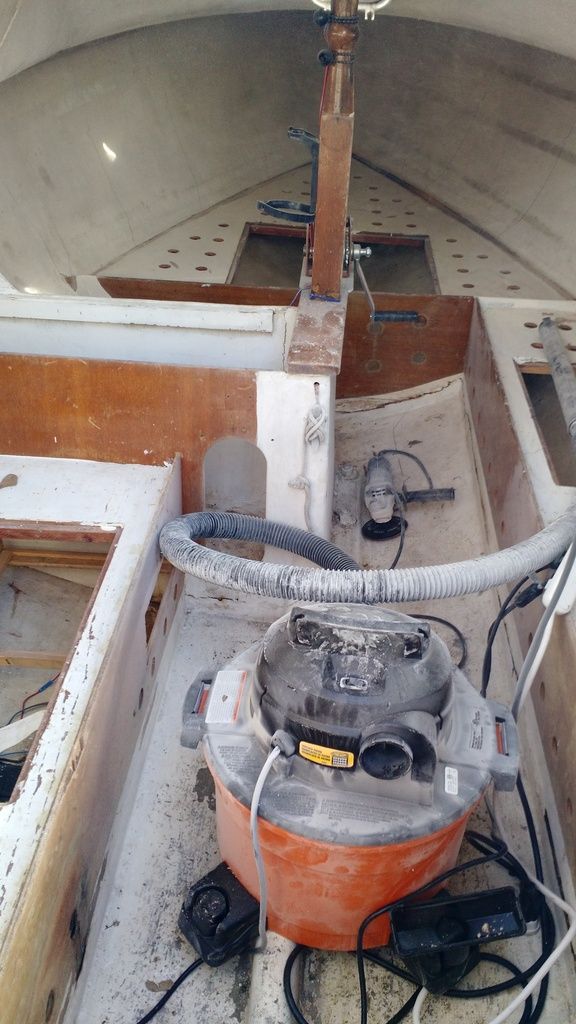

One part of the two-pronged attack on rotten plywood. Makita jig-saw.

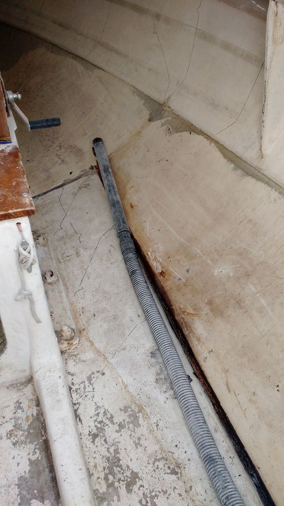

More or less where things are now: old plywood out, ready to start grinding down the little bit of glass tape/ plywood that's left from the jigsaw work. Also shows the other pincer: Makita 4.5" angle grinder with 24 grit fiber discs. The plan is to close off the areas under the coaming/ cockpit benches with a seatback on the port side and the main electronics panel on the stbd. We'll then cut hatches in the cockpit benches for sail, fender, and anchor storage.
