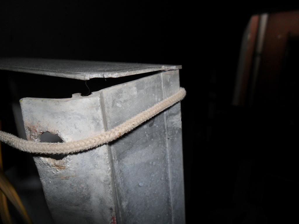

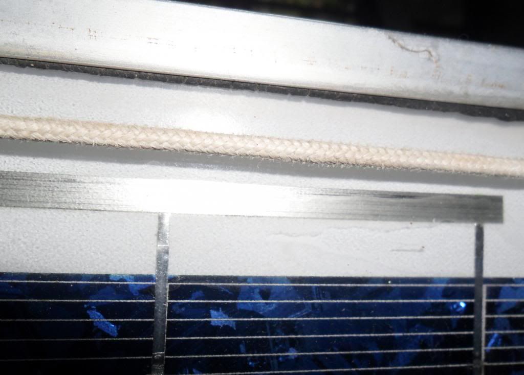

hey guys this is my panel...it was in the boat from the previous owner...works fine:)
and:
anybody got some solutions on how to reseal the edge and maybe what glue would work nicely and not damage the cells? its seems to have from the factory a black polysulfide or polyurethane type sealant...
I will redrill and rivet the aluminum frame or just JB WELD it with a strap of metal...
thanks

Christian, it's hard to see exactly how big the problem is from your photos (at least for me). I would try to "tack weld" everything in place with thickened epoxy and then seal with polysulfide sealant. It might not look beautiful, but I think it would keep the water out and protect the electrical thingies.

thanks yeah its half the frame that is loose from the actuall panel...its attached with the black looking sealant
the frame has 2 screws that broke off...
the black box where the wires are is sealed and cleaned up...
I really was just wanting to know if any black sealant we commonly use would be ok
sorry for the pics they are a but too close up

I would use an angle bracket to put the frame together and keep it there as you posted. I wouldn't use epoxy as I don't think it will work well - epoxy doesn't stick to plastic and the back side of many panels are plastic. I would use something like the adhesives found at Home Depot like Dap or failing that 5200. You won't be taking it apart ever anyway. With a tight frame it doesn't have to be very strong.

The job doesn't require an expensive sealant - any good one should work. 5200 if available is a good choice.

Not to labour the point, but I don't think any other structural silicone adhesive or bedding compound (Dow Corning, 3M, Boat Life etc.) calls for a primer. Sika recommends using their primer for best results, but when you see the price of a micro-sized tin of primer your hair will curl. FWIW, I've been using it without the primer with no problems.
I do like your idea of using aluminium angle to hold the frame together. Perhaps with rivets.

Rivets or 10/24 machine screws would work well. I think from what Christian has said most marine sealants are expensive where he is.
