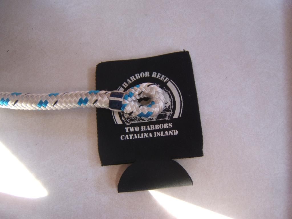

Outside-the-loop-thought:: Use seizings to put eyes, with or without thimbles, where you want them.
Leave a long tail, clap on 2 or 3 seizings, as you would for deadeyes and lanyards. If you don't trust your work, practice a bit more.
See Step 8,
HERE.
Seized Eye
Deadeye Seizing
