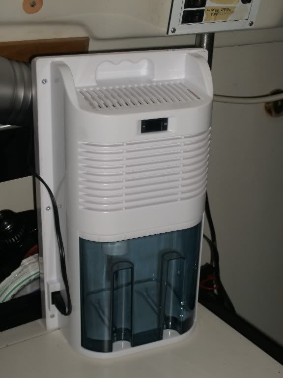

Someone asked for some pictures, and I finally got a couple. The first shows what the front of the unit looks like. But since the water reservoir and on-off switch are both on the back, I velcro-ed the thing, facing backwards, to the forward fiddle of my galley storage shelf (see second pic):

Thanks for the update! Did you say it can run on 12VDC? In a post you said the display model had a 12VDC wall cube but your pic seems to have a 110VAC cord.

The cord in the pic looks like a 120v cord, but it's actually carrying 12v from the power brick. If you wanted 12v operation, I suspect that you could easily tap into that cord with a 3-way switch (A-B-off) to provide a selectable power source. That would be much more efficient than using an inverter to go 12 VDC → 120VAC → 12 VDC.
I have no interest in 12v operation at this time. Either I'm at the dock with shore power, or I'm sailing with the companionway open. If you're at a mooring ball I can see how you might run this off a solar cell, although the power brick is rated at 60w IIRC, so you'll need a hefty cell.
Be aware that the internal fan is a little noisy, and the thing puts out some heat, so operating while you are in the cabin for an overnight might not be preferable. I just use it for while I'm away during the week.
