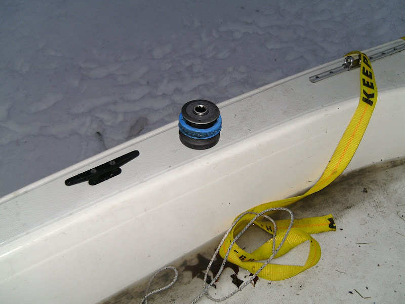

Discussion Starter · #49 ·
Cool, thanks! Learning all along, and loving it. Now I've just got to figure out where everything goes and how it's routed. Hopefully the book helps with that! :) If not, I'm sure I'll be able to recruit a sailor to show me, but I'd like to be able to figure out how to at least rig it on my own. What you've just told me is a definite help.
Anyone know where I could find a diagram showing where all these lines go? Will that perhaps be in the book?
I'm having a hard time picturing the routing as you explain it (due to my ignorance of how these things work, no doubt - no dig on your explanation).
Is the line for the mainsheet cleated to the traditional cleat next to the winch? I had it in my head for some reason that the traditional cleats would be used for dock lines, fenders, etc. and the self-locking type cleat things would be used to secure rigging lines.
Also does the line that raises and lowers the mainsail go through the ring foreward of the winch before heading to the top of the mast? That would make sense, I think. Here's the pic that explains what I'm thinking of. I'm picturing a line attached to the top of the mainsail going through the pulley (block?) at the top of the mast, down through the ring to the right of the picture, around the winch and then cleated to the cleat to the left of the pic.
Of course, I'm getting ahead of myself on all this anyway, as I've yet to figure out the proper way to secure the mast vertically :)

13 Posts
0
The mainsheet goes from the lower mainsheet block, through the mainsheet block at or near the end of the boom, and back to the lower mainsheet block, where you cleat it with the jaw cleat mounted on that block. The mainsheet doesn't go anywhere near the winches at each side of the cockpit.
The rope to raise the mainsail is the main halyard. It also doesn't go anywhere near those two winches. Those and the cleat next to them are for the headsail sheets. I'm not familiar with the Mac 25, but I'm guessing since there's no block and I see no other track for the headsail sheets, that those tracks and the cars on them in this picture, are the fairleads for the headsail sheets. The sheets run from the aft corner of the headsail (the clew), through the car on the fairlead track, round the winch, and are cleated off at that cleat. The car is moved on the track to adjust the sheeting angle.
My guess is that your boat will have the main halyard run from the head of the sail, over the upper sheave (pulley) and be cleated on the mast itself.
But get a sailor to show you, wait till you've looked more comprehensively at the books, or even go and look at some sailboats in the marina that are about the same size or smaller. You'll get it.

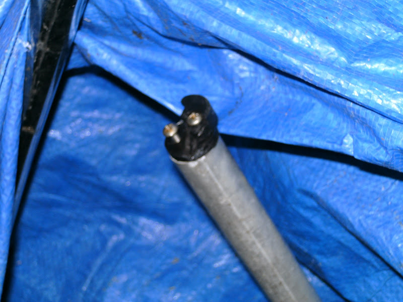

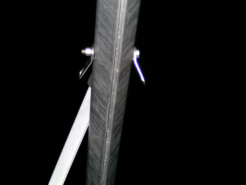

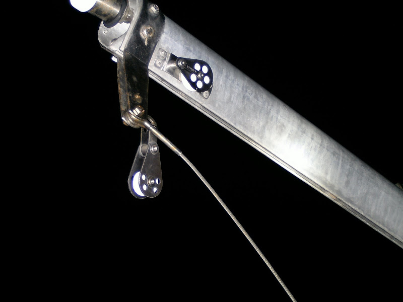

OK, I think I have a better understanding of what I'm missing in regards to standing the mast, which seems to be one of the first things I need to figure out.
I have a headstay (which also seems to be designed to hold the jib?) and a backstay, as well as shrouds (cables, in this case) that come from a short distance up the mast to chain plates mounted a couple feet to each side of the base of the mast on the cabintop. They can be seen in this pic.
I appear to be in need of the shrouds that would come from the top of the mast to the spreaders and then down to the deck. I believe those spreaders would attach to the brackets shown in this photo? Can these be line, or will I have to have them made from cable?
Does it make sense the spreaders would be mounted to the mast toward the top, but not right at the top, instead at the same location the headstay mounts? Here's a picture showing where I expect the main sidestays would attach to the mast.
Also, the spreaders do not seem as secure to the mast as I'd expect them to be. This could be the result of damage, or the way they are designed. Either way, they have play to pivot fore and aft. Below is a picture showing the spreaders attached to the mast. Also, there are brackets there that seem like they could be attachment points for more stays. Any ideas?
The part of the spreader where the stay would pass through is also broken. It looks like it could be replaced independently of the spreader itself, and may lend a clue to the more experienced eye if the stay that is intended to pass through it should be line or cable.
And for my last picture-question of this post, I have 2 pulleys (blocks?) at the top of the mast. Would I be correct in assuming one is for the mainsail and the other for the jib?
Again, thanks so much for the help. I feel like I'm making real progress already!
Disclaimer: The tarp is only lying over the mast like that to keep rain out of the cabin for now, I'll be building a wooden frame over the boat before any snow hits, to keep the weight of the snow from bending the spreaders, among other things.
Thanks again,
Dan

Discussion Starter · #58 ·
Thanks! I understand more now, but still not fully. I think looking at some rigged boats will help, but the books and having a sailor look at my boat with me will be the biggest help of all. Still, I'd like to learn and understand as much as I can on my own first, which I appear to be on the way to doing. Also, the less I'm missing when I get a real sailor to take a look at my boat with me, the more I figure he'll be able to show me. An example is the sidestays, I know I'm missing them so I may as well get them.
I can't express enough thanks for all the help I'm getting on this forum. You guys and gals are awesome. I can't believe how much I've learned in the past few days, especially this weekend alone!
Yes, those would be the lower shrouds, however you are missing the cap shrouds.
The Cap shrouds really should be made of 1x19 stainless steel. Riggingonly.com or another good rigging shop can make them up for fairly little money. I'd highly recommend replacing them all at the same time.
Spreaders never mount at the same point where the cap shrouds terminate, since the cap shrouds have to go over the spreaders as they go down to meet the chain plates.
I get the feeling that the spreader bracket is turned 90˚ from what it should be. Spreaders generally don't have to pivot fore-and-aft, but up-and-down. The spreaders should ideally bisect the angle the cap shroud forms with itself, so that the shroud doesn't put any torsional forces on the spreader, merely compression. There may be additional shrouds, especially if the mast has more than one set of spreaders.
I think one of those is for the topping lift and the other for the mainsail. I think the Mac 25 is a fractional rig and the jib halyard comes out a bit further down the mast. Both of those blocks are on the aft side of the mast, so neither would make much sense for a jib halyard.
Thanks again,
Dan

Discussion Starter · #60 ·
Good to know. I'll have to do some measuring, get some pricing, inspect the current shrouds (at least the spreader shrouds appear to be in good shape, surprisingly enough) and make an order. I've got a few months before I really have to worry about it, so there's not too much of a rush.
That makes sense. So the upper mounts by the headstay brackets likely are for the cap shrouds.
This is making more and more sense. This mast only has 1 set of spreaders, but that doesn't mean it's not missing any. Then again, all the Mac 25 pics I can find only show 1 set of spreaders, so there's a good chance that's all there's intended to be.
Again making sense. I was wondering what would hold the boom up!
Again making sense. Based on pics I've found on the web I believe you're right about it being a fractional rig. I must have either not noticed the lower block, not knowing what to be looking for, or it's quite possible it's part of the long list of things missing on this particular boat. Either way, I'll find or replace it (or maybe find it and then replace it!).
