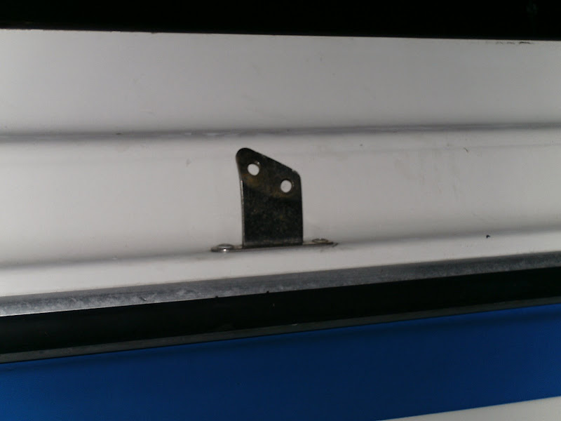

...I believe those spreaders would attach to the brackets shown in this photo? Can these be line, or will I have to have them made from cable?

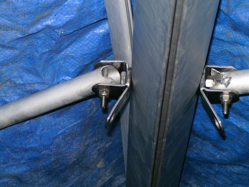

Below is a picture showing the spreaders attached to the mast. Also, there are brackets there that seem like they could be attachment points for more stays. Any ideas?
If the top picture is one of the chainplates, you may well find that you need the cap shrouds running masthead-spreader tip-chainplate; another set of intermediate shrouds running from the spreader bases to the other hole in the chainplates; and the lowers that you already have.
The big rigging suppliers sell a complete standing rigging wire set for many popular boats. You may want to compare the price for the whole set against the price for only the parts you need.
[Edit] Oh yeah. Shrouds go to the sides. Stays are for fore-and-aft support.
It appears you're right. After reading this post I searched the web some more, and found 2 sets of stays coming from the midship chainplate in a few of them. The angles of the stays suggest one could be going spreader bases, while the other would be going through the spreaders to the masthead. Here's are a few pics that are examples (I'm only linking the first because it's wide enough I'm afraid it will distort the page width):
