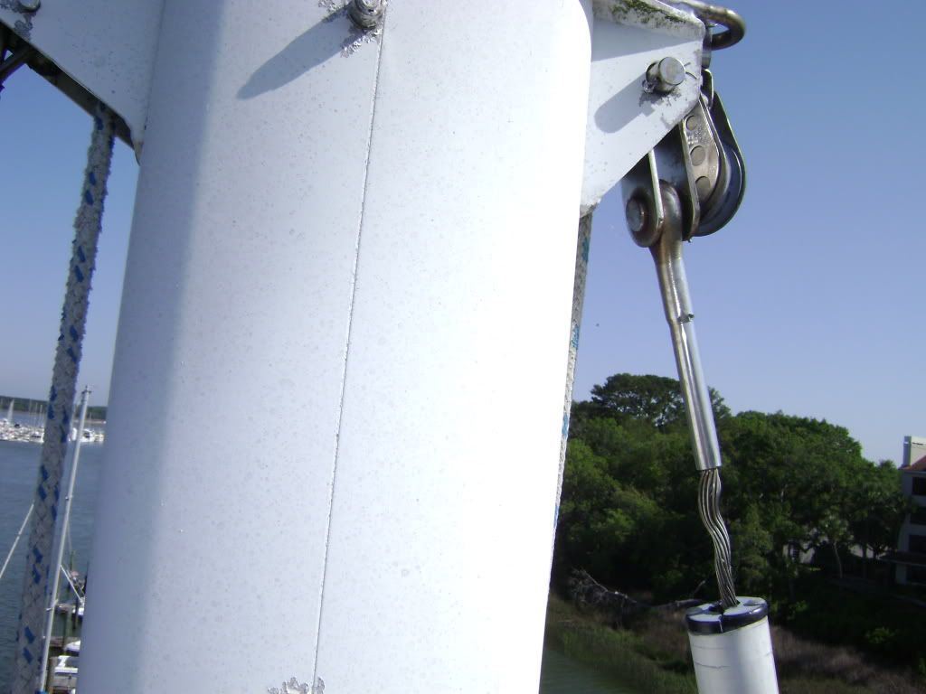

A friend of mine has a bit of a twist in his forestay near the masthead on his Catalina 34. Does this look like it needs to be replaced, or can he leave it alone? He's been having trouble with his roller furler, which is probably what caused the problem. Any thoughts?
Here it is:

that looks like the result of a halyard wrap...and it needs to be replaced ASAP IMHO.

A bit of a twist, just a tad of an understatement....holy cow, replacing it ASAP might not be soon enough...IMMEDIATELY....I wouldn't untie the dock lines with that forestay..tell your friend NOW, unless you don't like him

Sailing Dog is correct. That's definately the sign of a halyard wrap and likely the furling line having been led to a winch. Ouch!!
The forestay needs be replaced and a halyard guide needs be added to the front of the mast so that there is a least a 10 Degree angle between the alignment of the halyard and the centerline of the forestay when your pal's largest headsail is at full hoist. With shorter luffed sails he can use a luff pendent at the head of the sail to get the top furling drum to full hoist.

I'd point out that the clevis pin for the toggle at the top of the forestay, in the masthead casting, is also a bit too long.

So if I'm hearing you all correctly, you're saying that he should leave it alone and that everything should be just fine. I'll pass this along... Thanks again!

Forgive me, I'm a BRAND new boat owner and today I found that I have what appears to be the EXACT same issue on my C&C 24 ( in fact I thought someone had taken a picture of my boat ) ... how much does this type of repair cost ( approximately ) I'm going to be calling someone tomorrow to find out but it might be nice to have an idea before I call them and fall over with shock!

It's gonna cost you a new forestay which you can estimate by looking at any marine catalog for your size wire, a marine eye and a swage stud. And then the cost of labor to remove the furler from the boat, and depending on the system you have, the partially dissassembly of the system and the replacement of the wire. Some riggers may choose to use a mechanical fitting on at least one end.
I would usually estimate at least three hours for a job like that.
Make sure that you have a halyard restrainer installed while someone is aloft. If the swivel is still too low, have a pennant added either to the head or tack of the sail also.

Thanks for the post. Can you offer any round numbers as to what it would cost to replace the forestay on a Catalina 34?
What kind of furler do you have? That makes some difference. Is your rigger mobile or are do you take it to a yard?
I would charge about 200.00 for the headstay alone. That's 9/32" wire with a 1/2" eye on top and a 1/2" swage stud on the bottom.

Throw it away and get a new one. Also, your halyard is nearing the end of its useful life...
yeah ... geez ... and while he's at it tell him to get that masthead sanded and painted up quick :)
