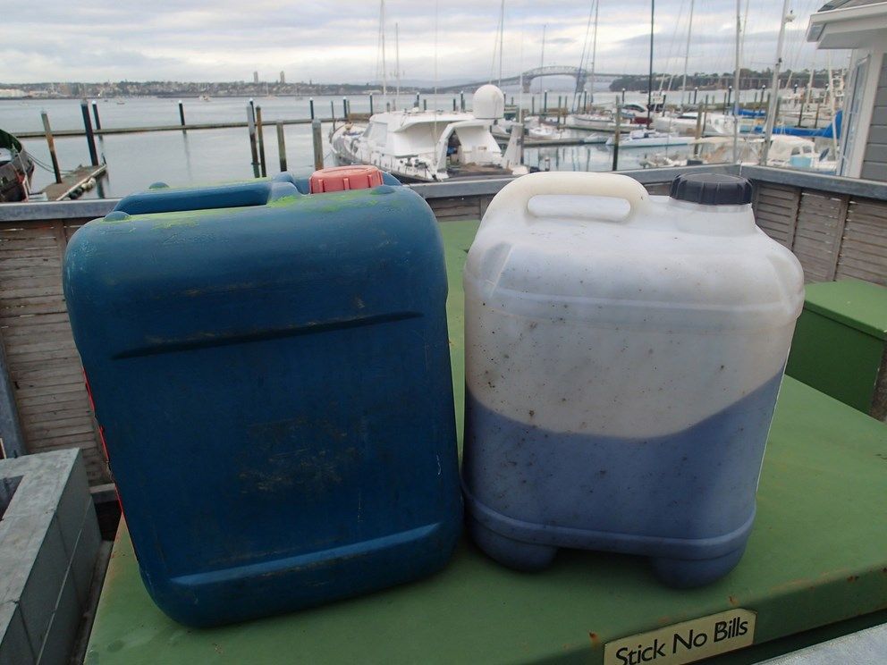

I am heading up to PNG and Indonesia in a few weeks and this time I will have an extra piece of equipment, a gasoline powered dive copmpressor. There will be five of us on board, all divers, so the thing will be running a lot. I want to take some extra gas above the regular jerry cans I carry for dinghy fuel but they are trerribly expensive here in NZ/. The shop near my mooring has loads of these oil and hydraulic fluid jugs in the recycling area and i was wondering, Why not use some of these? They are obviously OK for petroleum products and very sturdy. Because they have no vents, if I avoid filling them all the way to leave room for expansion, is there any reason i shouldn't carry these as backup? I will clean them thoroughly with a bit of diesel first. Any red flags here?
Thanks

Nope. I've used the same jugs, though they had cooking oil in them previously. I didn't even bother to clean them out too much, the cooking oil would likely do the diesel engine some good. The only issue is make sure you've got a good funnel with a wide mouth because pouring from them can be a pain. Also, if you don't fill them completely, and pour while holding them sideways, they're easier to pour without the "glug glug splash!" that can happen when pouring from a traditional position with a fully filled jug.

You're good to go with those. You've covered contamination and venting. Can't imagine what else would be a problem.

I can't speak for NZ but in Canada and probably in the USA as well these are not approved gasoline containers and as such can be refused at filling stations. They would also in some cases void insurance coverage.
I have never seen a vented jerry can. To me it would be unwise to allow for venting except when emptying as gas vapours would present an ever present chance of explosion and or fire.

I've used the cooking oil containers in Central America for diesel with no problems, but would worry about gasoline due to the higher vapor pressure. Diesel leak smells, gasoline leak can equal a really bad day.
Colored containers stand up longer in UV than clear. Either will eventually harden and crack.

Nobody here has mentioned the possibility of static buildup, and its potential to spark an explosion or nasty gasoline fire. Any plastic container that is not specifically designed for gasoline may be susceptible to static buildup. (I've always assumed that approved plastic gasoline containers have conductive additives compounded into the plastic to prevent static buildup.)
For this reason, I would NEVER put gasoline in ANY plastic container that was not specifically designed for the purpose.
Even containers that were designed for kerosene or diesel fuel would not be acceptable. Not all petroleum products are the same. Kerosene and diesel are not flammable (they are merely combustible), so I would expect that their containers do not need the same level of anti-static protection.
I hope you guys who are advising that he use these cans are ready to bear the liability for the injuries that your misguided advice might cause. :mad:

I few years ago I did an accident investigation regarding a tank that was ignited by pumping static./ I would have thought it was a million to one... until I saw it. And for all you guy that think diesel is better because it can't explode, it was ULSD (mist from high speed fueling is explosive).
Read this from CDC regarding filling gasoline jugs.
CDC - NIOSH Publications and Products - Fire Hazard from Filling Portable Gas Cans in Pickup Trucks and Cars (98-111)
This is the wrong place to save a buck. Personally, I hunted up some non-carb jerry cans. The carb design causes more spill and emissions than it saves, I have no doubt.
Regarding can over pressure, the cause is E-10. The vapor pressure is considerably higher than non-ethanol gasoline but they are not yet designing for it.
