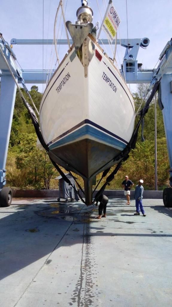

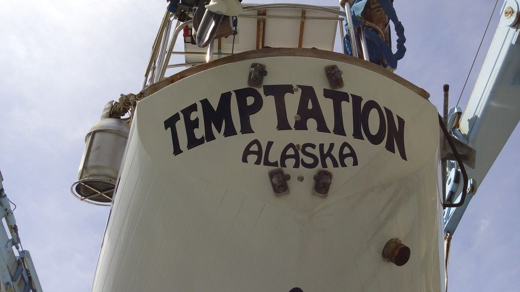

I have an Islander 44. Narrow beam, just 11' however what you may like since you want to stay in cold water is the fuel tank. It is in the keel so there is no temperature changes hence a lot less condensation. The owner before me was in Alaska.
However I have it in a much warmer climate now. There has been 10 44's built and a few more 41's (same as a 44 but 3 feet chopped at the stern) built very strong.
