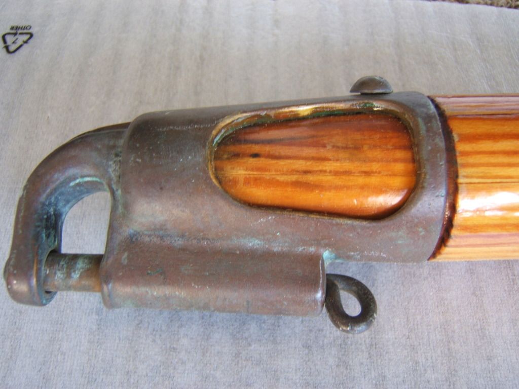

I dig that old and funky, too! There a couple of pair on Ebay right now. Same ones, it looks like. Problem is, they are for a 3 inch pole and where am I gonna find a 3 inch pole that is strong enough, down here in Florida? Man, that would be a heck of a whisker pole! 3 inches in diameter and 11 ft long! It is cool though. I thought of buying them just to hang in my shop. Well, there's a Marine flea market at my marina, tomorrow. I'll see what's there. If I don't find anything, I'll order a new one from Defender. Thanks for showing me that old brass fitting. Pretty cool..... Kevin
