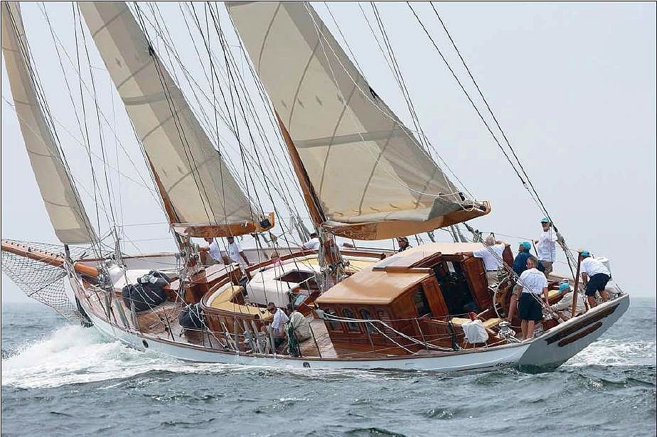

My Dad had several wooden sailboats. The one pictured is virtually identical to the last one he had. IIRC, it had a solid wood mast about 8" in diameter at the base. He also built an International Star Class boat with a boxed mast of Spruce, a piece of wooden artwork.
The thing I remember most about wooden boats is sand, varnish, & paint. Our last boat had an aluminum mast & glass hull. We spent way more time sailing it than polishing it. Aluminum doesn't rot. :D

Cant get pics to upload:
Paul Thomas's (ptnt11085)'s Library | Photobucket
Boat picture is of a virtually identical boat we had when I was about 10 years old, on San Francisco bay, about 1945
