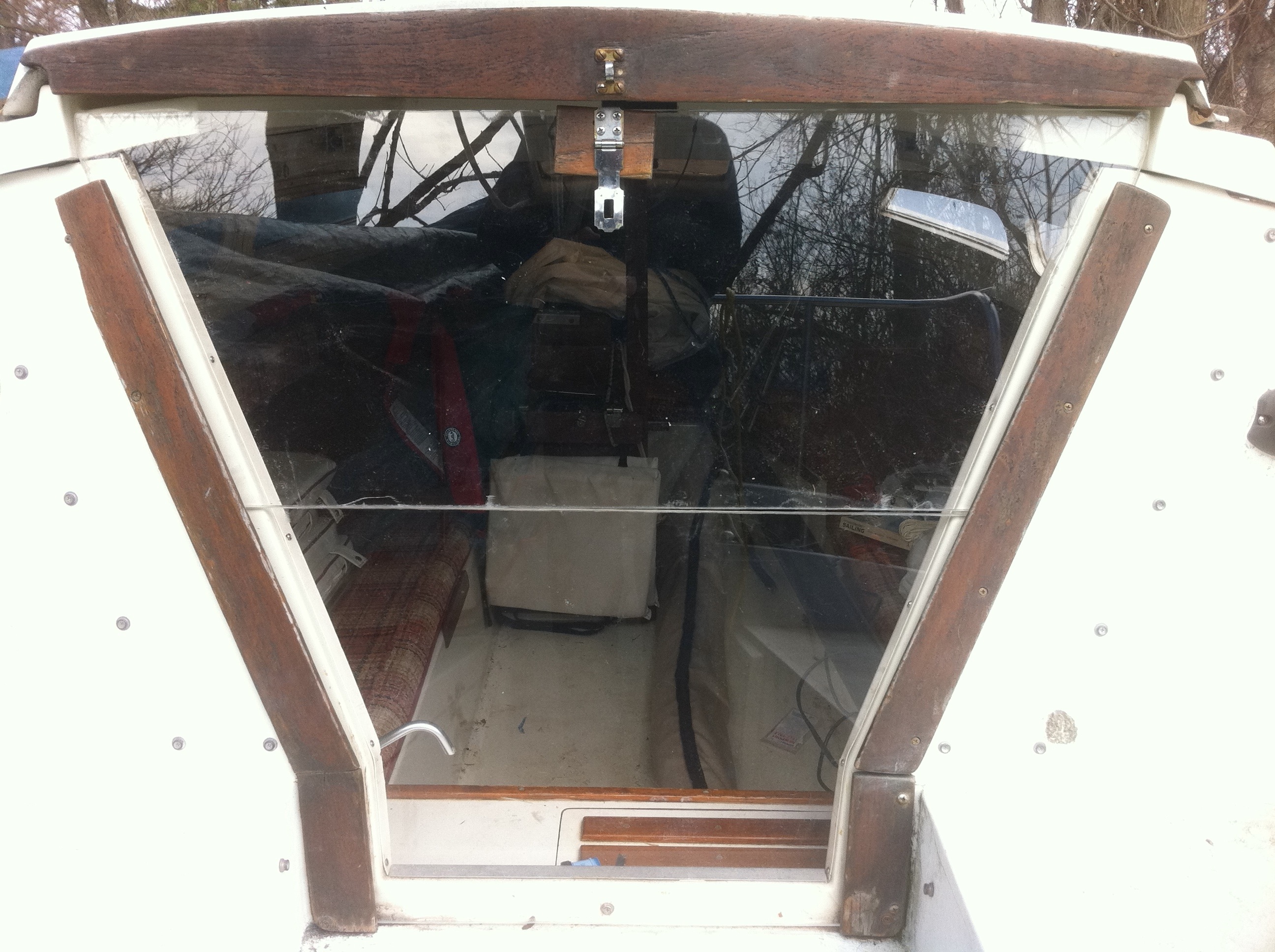

SPRING 2011: All new standing rigging including on the way for my 77 Spirit 23 from Rigging Only in Mass. Sent them my 33 year-old rigging and they duplicated it all w/ new. Will be re-bedding the side deck plates as well, installing a remote for my 92 Johnson 9.9 hp, replacing sink drain hose (new seacock installed last year), refinish ext wood and some light scraping & touch up of bottom paint. I've replaced the cabin hatch w/ plexiglass.

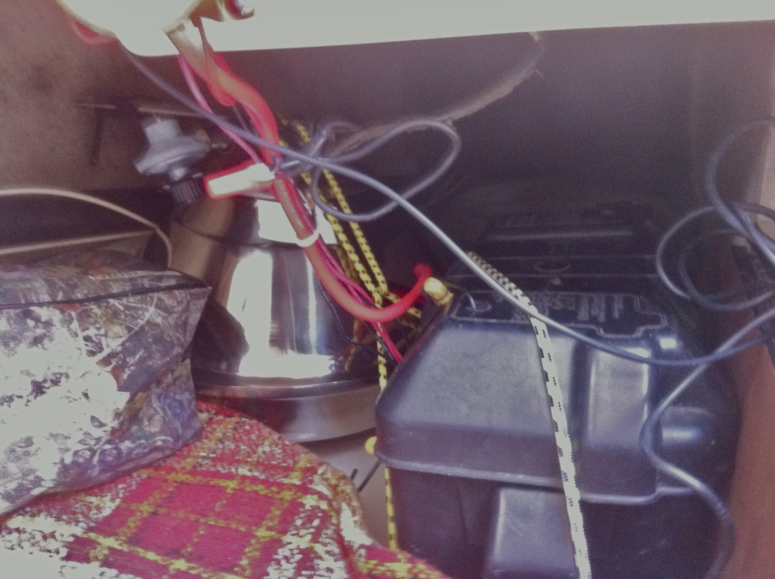

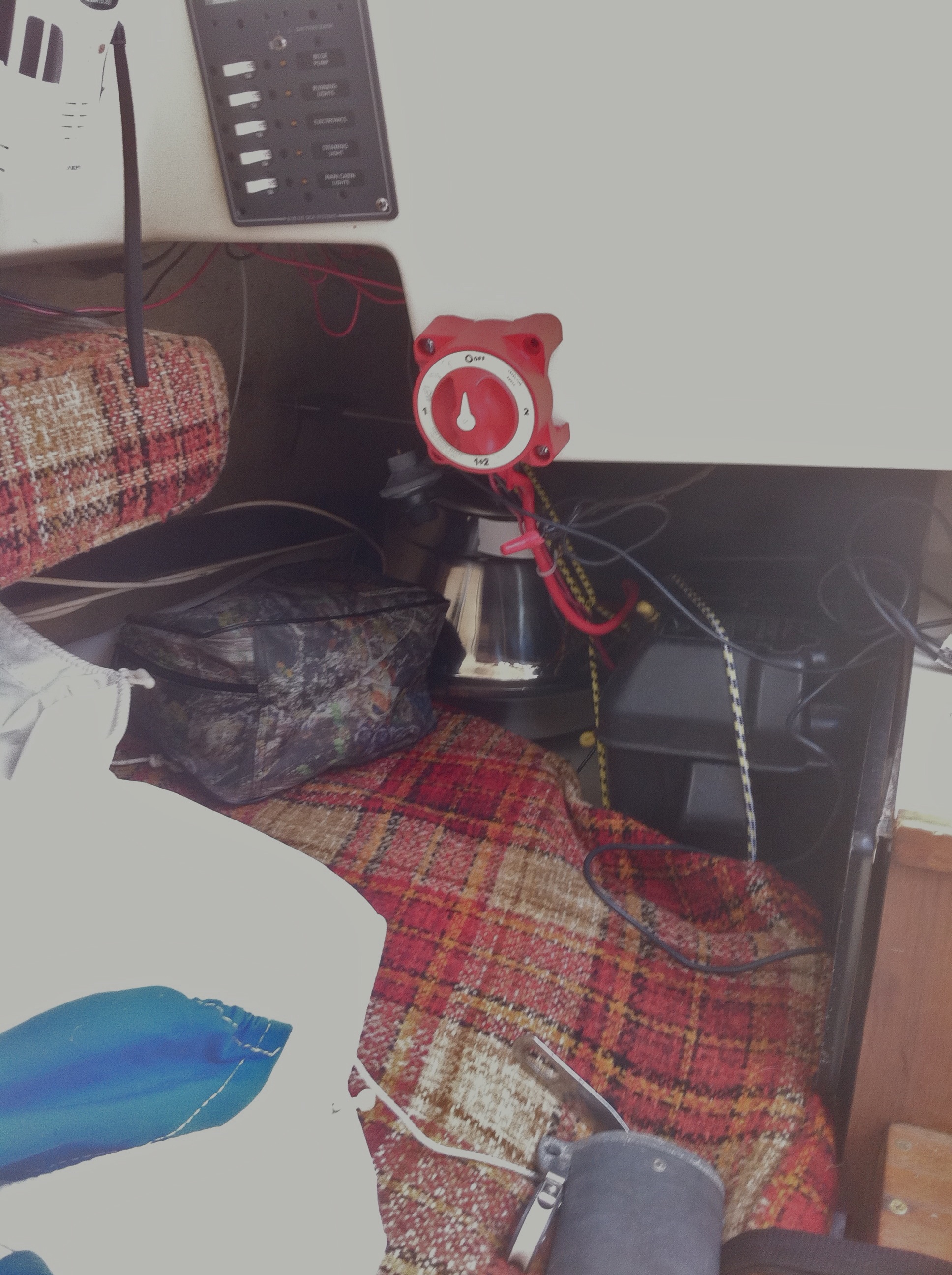

Cabin Battery Housing
Finally a picture of my Cabin house battery arrangement. The Batt Box is Secured by BUNGIE Cords hooked on metal door handles attached to the seat. I use the area BEHING the battery for storage of Spinaker pole, sails, grill, etc.
