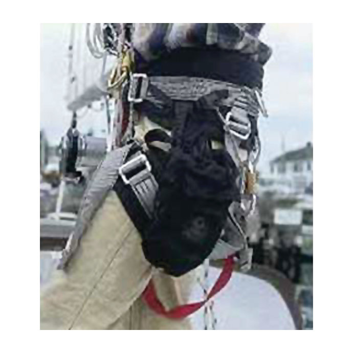

ATN's statement that it is the only solo system that allows you to work above the masthead is baseless. I'm in the top steps of a Mast Mate. The straps around the masthead are just for extra stability and leverage.

Aloft work need not be dangerous, although I see a dangerous practice in the above photo.
If I am seeing clearly the user is relying in the base of the tri color to restrain the straps. I understand that they are there for stabilization, but that leads to difficulties/. You want to get that extra inch so you put more weight on then when it fails bad things happen. So it is a temptation hard to resist at times.

... although I see a dangerous practice in the above photo....
I seriously doubt that, since you cannot not see everything from either angle, but please elaborate.

Notice in post 6 that I add wide pads on the leg loops. Nothing fancy, just exercise tile foam and ducts tape. With the padding, I can stay as long as I need, and I've been up there a good while installing lights and instruments. Tower climbers and professional riggers use this sort of padding. A standard climbing harness is murder after 10 minutes.
