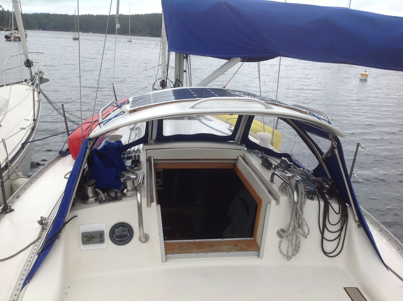

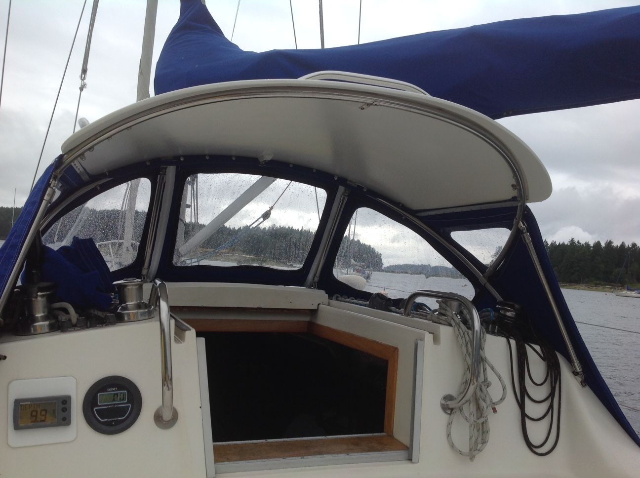

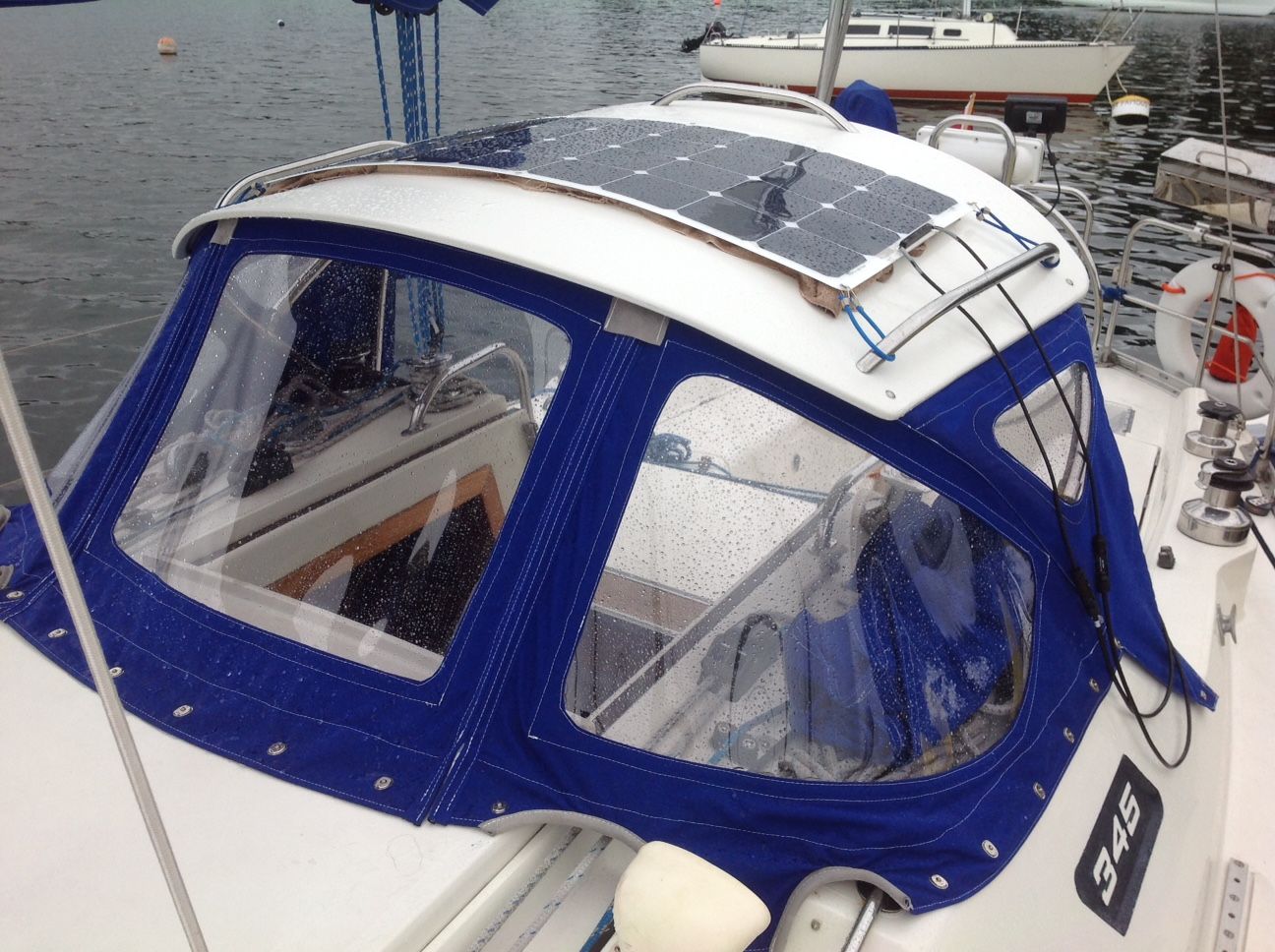

#32 · (Edited)
Update:
We finally got around to getting this done and installed, the latter literally within an hour of departing for our recent 7 weeks afloat. The hardtop was fairly straightforward, the canvas portion not quite so simple, in the end a (good) friend with a good machine did it for us.
I stuck with plan A, ie laminated Baltic Birch ply, two layers of 1/8 with an additional two layers around the edges for visual bulk. It's quite light, doubt it weighs more than 10 lbs. This plywood comes in 5'x5' sheets, I'd have liked a few inches wider but decided to avoid any seams. Cost was $17/sheet and two did it with leftovers.
The whole thing is sealed in an Amine-free epoxy https://systemthree.com/products/silvertip-laminating-epoxy-resin since we planned to paint this thing and have had bad experience with paint and amine blush before. Nice stuff to work with, almost crystal clear and it took about $100 worth to thoroughly seal the piece.
Since I wanted a good match with the deck gelcoat (and couldn't tint Brightsides) I took a small hatch cover to a local Home Hardware and they matched a can of Rustoleum ($15) very nicely indeed. The paint went on nicely, and no issues to date (it is early, though, and interested to see how all this weathers over the winter)
I glued on some pads to clamp it to the frame at the midpoint using some small modified West Marine tangs, and though the original plan was to secure the top at the sides with the handles, we ended up using SS carriage bolts through the frame, and bolted the handles through the top with heavy washers for backup. I liked the smooth look of the carriage bolt heads over the hex bolt heads. We also added a central handle at the aft edge, which turned out to be a very useful, natural handhold esp in a seaway.
Another unforeseen benefit has been the increased brightness below (white overhead rather than blue canvas) and, hand in hand with that, cooler in the shade with the more reflective top.
The results below:
