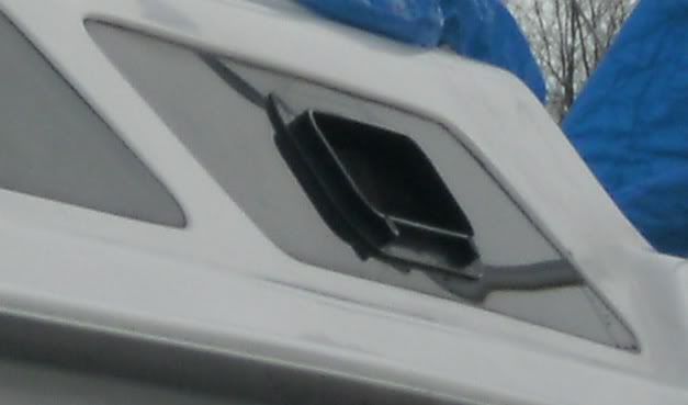

#13 · (Edited)
I have a similar question, slightly different application.
My head has a "rain drain" type of opening port in the middle of a plexiglas (acrylic) window:
I need to re-bed it because of a small leak. There are through-bolts from the inside to what I believe are molded threads in the outer flange. The flange is about an inch wide.
Is butyl tape an appropriate glaze for this, or is there some chemical incompatibility with the plastics?
