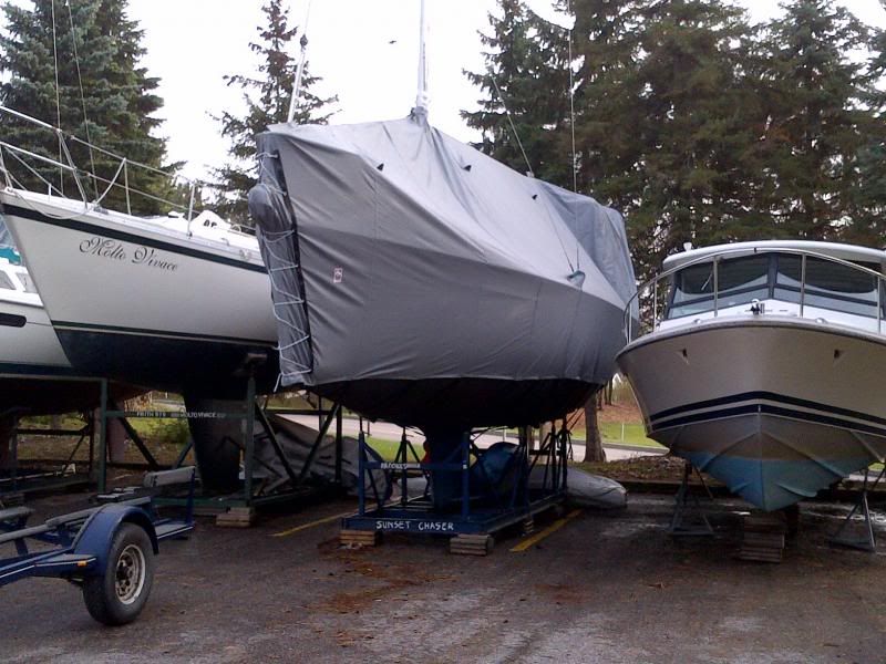

#45 ·
Just finished tarping for this winter. Some of you guys way overthink this. The guy next to me (to the left in the photo) had some complicated homemade pvc/2x4 system he was erecting. Appeared that he and his wife had been there for a few hours before I got there, and were nowhere near putting the tarps on before I left. For this year, about 2 hours and $8 for some additional line for tie downs. I'm in northern New England with big snows and winter storms.

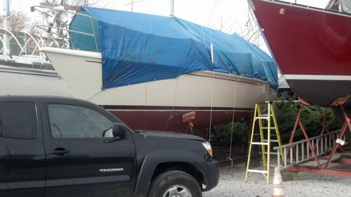

#50 ·
Hey, caberg, if it works for you, then who is anyone to say otherwise. It certainly wouldn't work for our winter, where we lots of snow and nasty winter storms (high winds). If your boat was up here that tarp would quickly chafe through at the stanchions, the grommets would rip out, and you'd end up with first a pile of snow in the collapsed tarp. This would turn to a large glob of ice, risking the stability of your boat on it's cradle, let alone the possible damage the ice might cause.
The point of covering the boat is two-fold. You want to keep snow off to avoid weight loading on the boat, especially in the cockpit, but possibly also on the deck (although that's less on an issue). But the major issue is to protect against freeze-thaw problems. Snow-covered decks will promote water intrusion. Cored decks that have thru-fittings will be at risk in freeze-thaw situations, and if (and when) you have water intrusion, then freeze-thaw cycles will start to cause real damage.

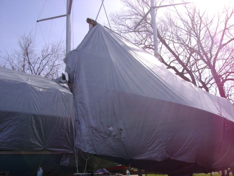

The best way is anyway that works well for you.
Used a silver, hay bale tarp that lasted 6 seasons ( 1 too many as silver flecks covered the boat last year ) Supported a 2x4 ridge with vertical 2x4's lashed to the mast, and forstay. Used rope from the ridge to the bow cleats, mid cleats and stern. Used a multitude of tarp rope grabbers until I found one that really worked well that actually screw through the tarp and had an eye for the rope. Tied off underneath and kept the tarp tight. Ziplocked a poly skirt to the mast at the pening to shed water / snow and used tarp tape to seal the cuts down the sides for the chainplates.
Never had any snow accumilate on the tarp and zero issues over the 6 seasons.
Finally tossed that tarp last spring and bit the bullet for a custom tarp, very similar designed as the silver tarp. Installed in half a day.
