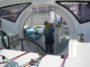

Sorry, but that's becoming a heretical notion, today... What, you didn't see that Mega Throne mounted behind the helm on the Seaward 46 at the Annapolis show a while back?
Every year, I'm seeing more and more boats being fitted out with these things... Time to get with the program, Rich... :))
Hard to imagine a more comfortable steering position in a seaway, no?
Sailing comfort is the Helmseat

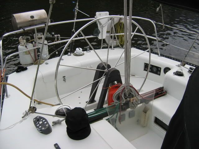

Our last boat had an 'ego' wheel, and a somewhat unique A frame support pedestal.. We did a lot of upwind sailing and the best seating was outboard, to windward, straddling the wheel with your feet propped on the sides of the pedestal. Loved that set up!
Reactions: T37Chef
#30 ·
Nice... but, I'll bet that setup might give one pause, when maneuvering around behind the wheel during a switch of the helmsman on a dirty night offshore, no? :))
I've never been able to shake the feeling that the massively oversized wheel on his J-46 CIELITA might have been a significant contributing factor to the loss of Ned Cabot in a gale off the west coast of Newfoundland a few years ago. After all, he had just come on deck, and was in the process of taking the helm when they were knocked down, and Ned went overboard...
That's always been one of my biggest objections to wheels on smaller boats, the risk of exposure during the simple act of climbing back around them...

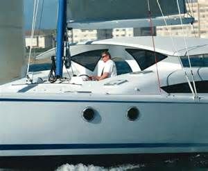

Well Jon, sadly I guess youre correct ... have you ever seen the 'helm station' on a Moxie "Island Hopper" Catamaran? .... complete with a round dining table sized 'window' and located directly behind the mast?
If you havent, imagine steering an 18 wheeled over-the-road Kenworth semi .... with the steering wheel just aft of the friggin RADIATOR. WTF :eek:

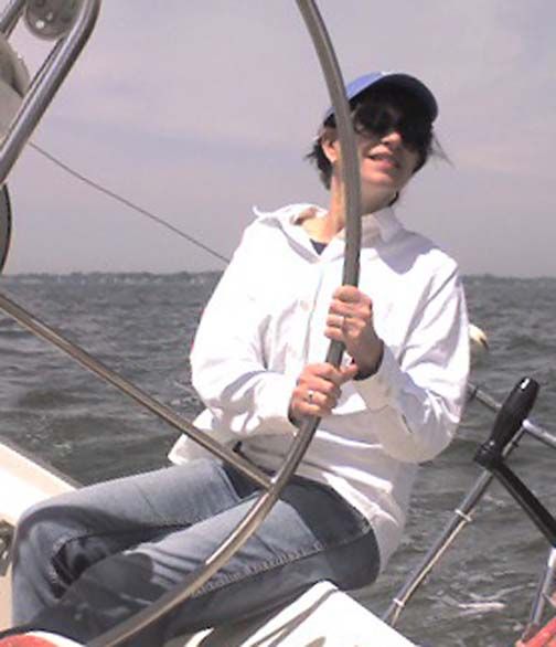

My boat came with three wheels; a 60" four-spoke, titanium racing wheel, a 56" 10-spoke, stainless steel offshore racing wheel, and a 42" 'cruising' wheel which I suspect was the original wheel for the boat. The 60" racing wheel is an abolute joy to steel. The lack of momentum and precision teel is amazing.
The 56" wheel has a very solid feel, but it has a lot more momentum and so is a bit more tiring to steer and you feel it in your wrists after a very long sail (8-12 hours on the helm).
The downsides of the big wheels is that it takes a bit of wiggle to slither past the wheel and the space between the wheel and the side of the cockpit is not for the corn fed.
I have only mounted the 'cruising wheel' once. Besides for looking silly and not being able to reach the wheel when sitting in a postion where you could see over the cabin or look up the slot, it was very difficult to steer a straight course since small movements of the wheel were bigger movements of the rudder and it took more force to move the wheel so you were more prone to oversteer.
(My wife Barbara testing the limits of heel before a wipe-out, not that she actually wanted to find the limit....)
Jeff
