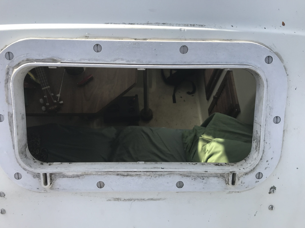

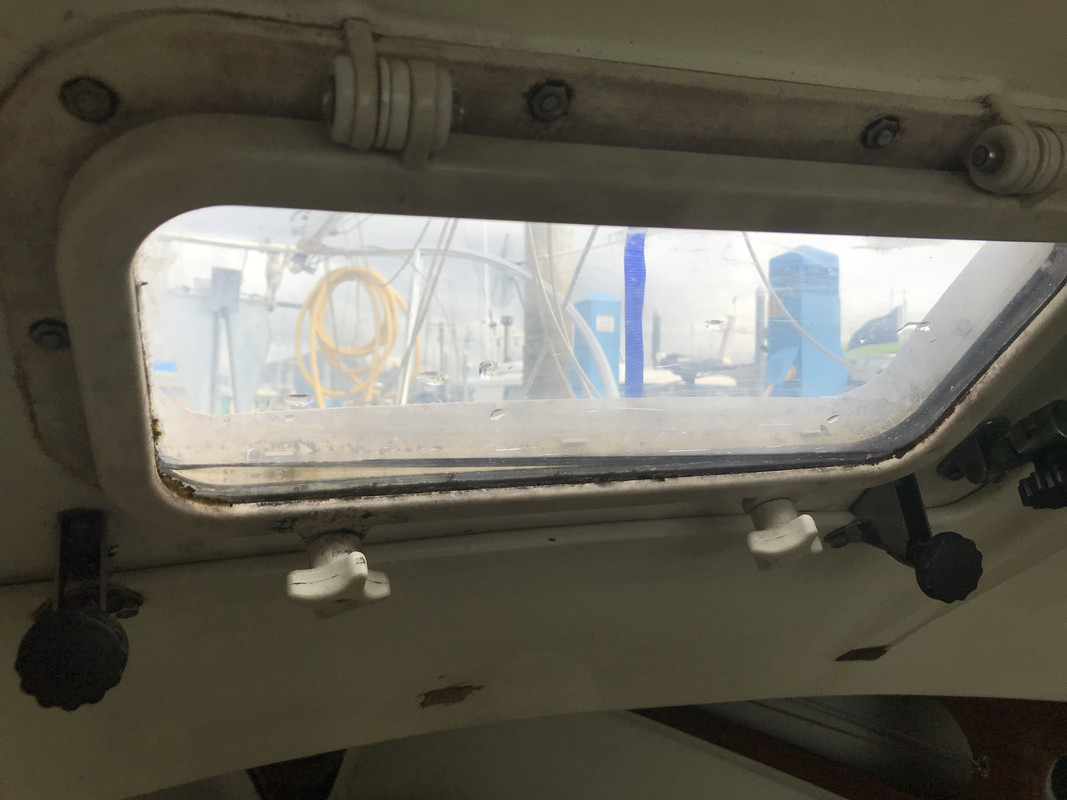

I had the same style front window in my Parker Dawson and it was also a persistent scourge that was determined to dribble on my bed. I replaced mine, as well as the far aft port, with Beckson fixed deadlights (a portlight that does not open) and had not had a leak since. I did not find the opening port to be particularly useful since if I wanted air flow I would just open the hatch anyhow and with the fixed deadlight I can still see out which is occasionally handy when it's yucky out and I end up using the front cabin as a pilot house and just letting Otto do the steering while I keep and eye on everything from the comfort of the cabin toasting my feet with the forced air heater.
Previous owner added a second window to the outside of the hatch in an effort to keep the water at bay. Clever looking solution that in practice did not actually work all that well.
Beckson fixed deadlight (this one in the ft cabin)

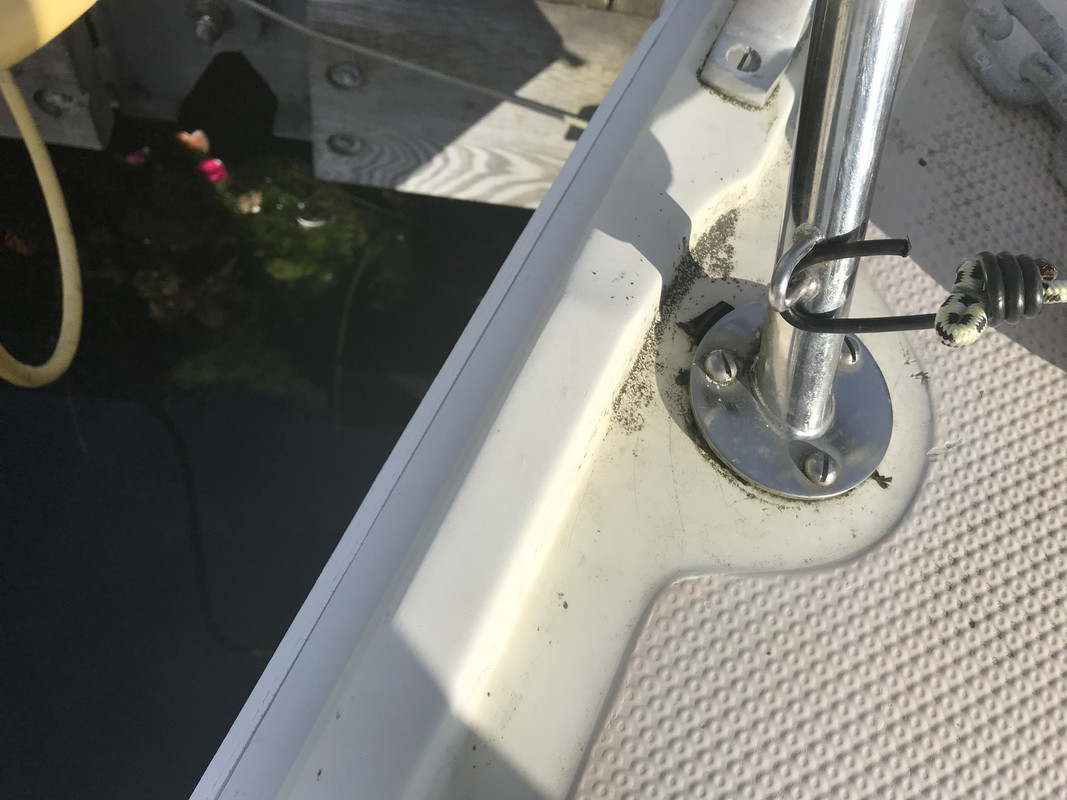

Leaks from the stanchions and pushpit have been a bit of a nuisance. I can usually get things under control by pulling everything, cleaning up and rebedding with Butyl tape but in time they always creep back to leaking. I am looking for a better solution this season so stay tuned and we'll see if we can engineer a solution that puts that one to bed for good.

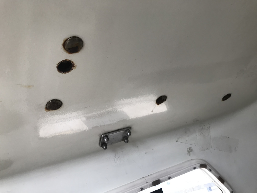

The little plugs you just remove. Drill a little hole in the middle (try not to accidentally drill into the screw underneath) then use a wood screw to grab the plug and pull it out. That gives you access to the screw from the top. On the bottom side, just pry off the covers which will then give you access to the nuts on the bottom side. I usually use a nut driver on the bottom and try to just hold the screw still up top. I the caps on mine with white plastic caps from the hardware store instead of the rust prone metal ones. In several places, I added an additional eye bolt to the bottom which I then use to attach bungees that then do handy dandy things like hold my paper towel rolls and such.

Replacing the forward/aft ports with Beckson deadlights solved all my leaking issues in the aft. The forward deadlight still drips a little, but I'm guessing that's my fault during installation. I'm contemplating taking the deadlight out entirely and fiberglassing over the hole since the whole hatch opens anyway...
I reseated stanchions with butyl tape and found it very straightforward to work with and so far no leaks. I may have to maintain that every few seasons, but it wasn't a huge hassle, as long as you've got a buddy to help you.

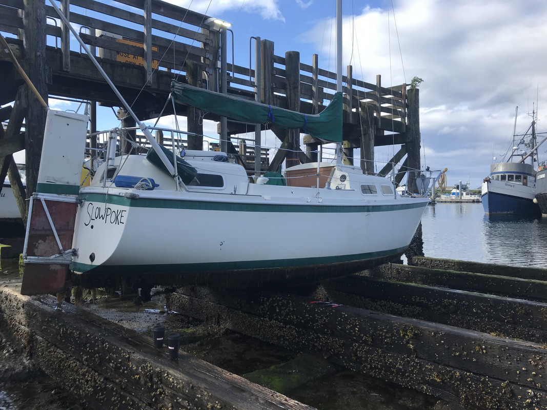

I recently put Slowpoke on our tidal grid, and put on a fresh coat of bottom paint, after scraping off a colossal number of mussels. I replaced the prop shaft zinc, as well as a zinc on the keel. I saw no evidence of a prop nut zinc, and I couldn't find any info online. Does anyone know if I need one there?
Here's Slowpoke on the grid, pre-scraping. It was nice to see the bottom!
If anyone has questions about using a tidal grid I'm happy to help. The process wasn't super difficult, but there were some things I wish I'd known a little better before my first go at it! Although, my understanding is they don't really exist anymore outside of the PNW...

I've got a persistent leak from the window on the forward hatch of the forward cabin. Has anyone else experienced this or have any ideas on how to fix it, short of replacing the whole thing?
Here's the window from the outside:
And here's the window from the inside, where you can see how the water pools up in the window. There are drain holes on the fitting, but the window rests below them, so water always fills up here with the copious amount of rain we get here in SE AK.

I've got some water seeping in at a couple of stanchion bases, where it looks like old gaskets have worn out. See this picture for an example:
The research I've done on this project has led me down endless rabbit holes of products to use - LifeSeal, Butyl Tape, Epoxy, Form-a-Seal Gaskets, etc. and I'm a little confused about all these different marine sealants... I'm wondering if anyone has done this before and could offer advice?
Thru-Deck Interior Caps
I'm also getting some leakage through these rusted out caps where the deck rails bolt through. I'm not sure how to get at these, since there are wood plugs covering the top of the bolt up on deck. I'm also not sure what to call these little caps, and I'd like to find more and replace almost all of mine, since most are rusty and unsightly, or just missing and unsightly:
